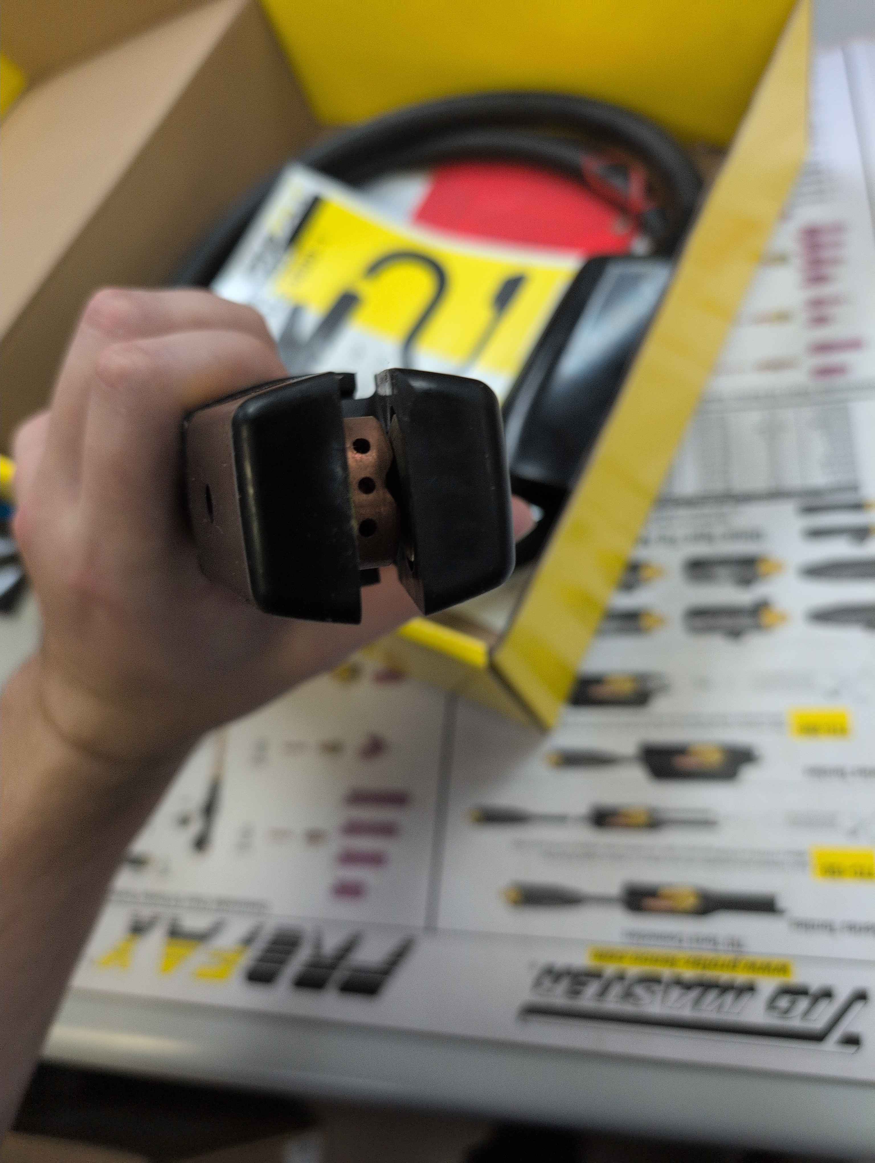

@Alexa still in the store but here is a Carbon Arc Gouging torch
9:27 PM
9:27 PM
Oh wow look at that!
Avatar
HopefulMGowner 1/31/2025 9:28 PM
This one has the holes directly under the rod but I think it could be on the handle
Avatar
That makes sense - It's a lot better now that I can see a working example. Very cool!
Avatar
HopefulMGowner 1/31/2025 9:31 PM
Here is how it attaches
9:31 PM
Avatar
gotcha - just threads together real nice

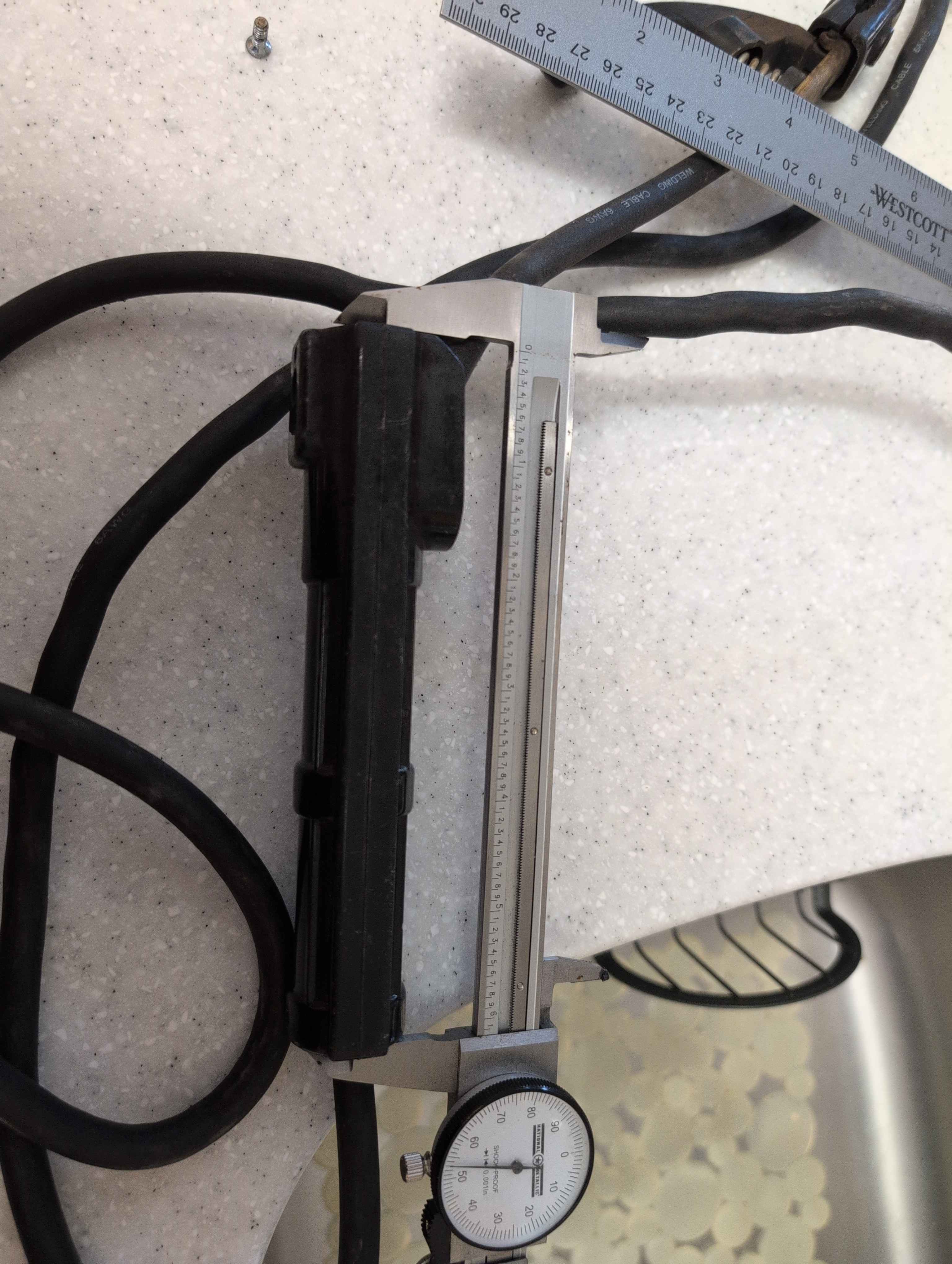

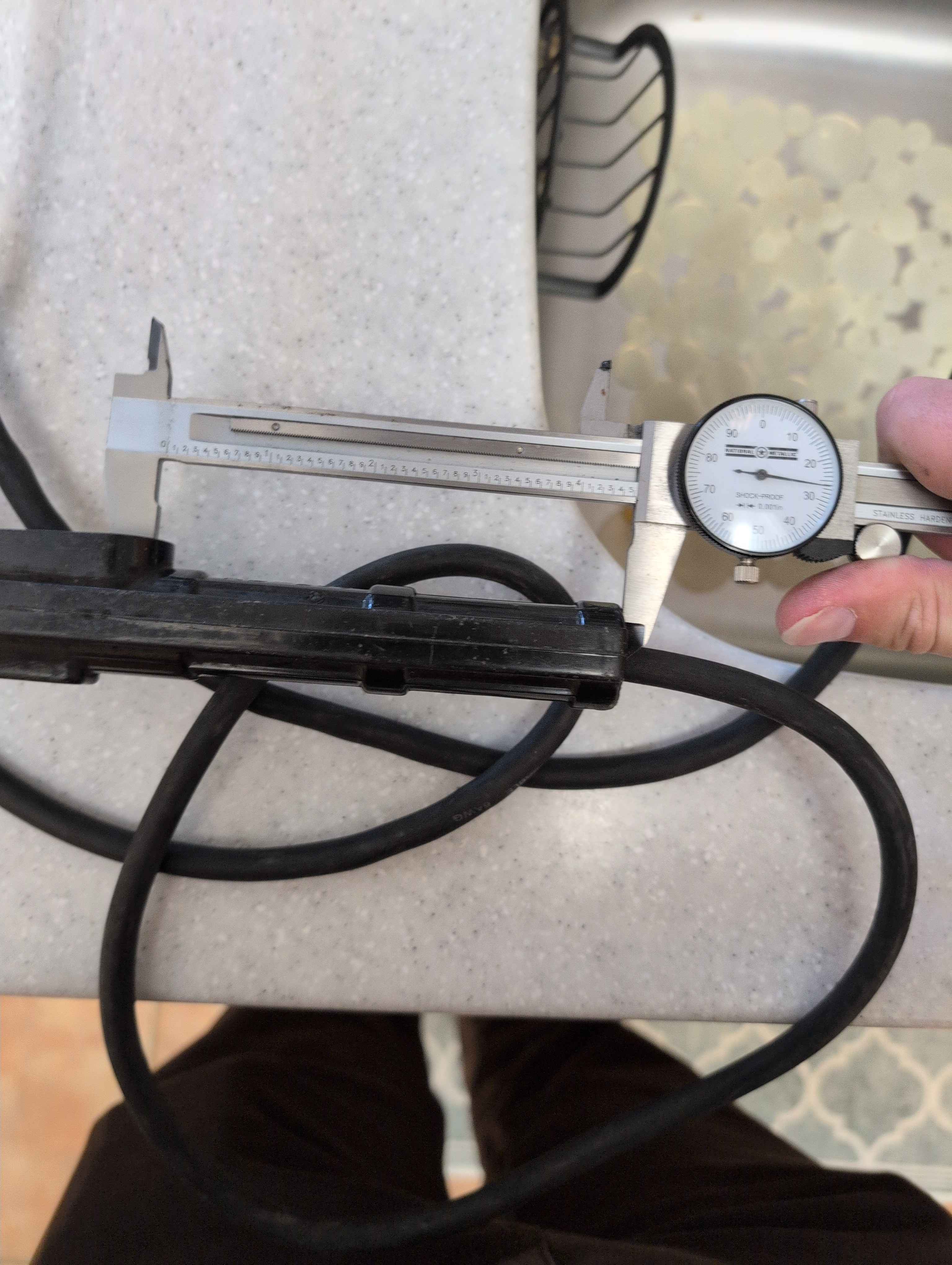

HopefulMGowner 2/1/2025 8:00 PM
More stuff on a OSHW Carbon Arc Gauger
Avatar
HopefulMGowner 2/1/2025 8:08 PM
8:08 PM
Normal stinger handles slip over the cable first and are attached by a single screw to the hinge mechanism
8:14 PM
This example measures 6.153 inches (156.28mm) in OAL and 4.526 inches (114.96mm) from the start of the hinge section to the base
8:14 PM
8:15 PM
An up close example from the hinge cut out to the base
8:15 PM
8:18 PM
The OD on the ridge was measured at 1.073 inches (27.25mm) and the ID was found to be 0.825 inches (20.95mm)
8:18 PM
8:21 PM
From the handle mounting hole to the bottom of the handle was 5.694 inches (144.62mm)
8:28 PM
The width of the lever section appears to be .758 inches(19.25mm)
8:29 PM
8:31 PM
8:32 PM
The length of the lever section appears to be 1.65 inches (41.91mm)
8:34 PM
I estimate the radius at the bottom to be between .325-.5 inches (8.25-12.7mm)
