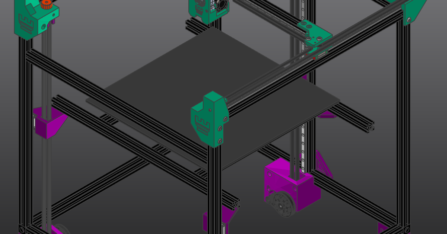

If I understand it correctly it’s a Cartesian machine. X rides on dual Y axes but each axis is independently belt driven including Z

The print quality has been good after ironing out the initial bugs! The D3D pro is also readily scalable to pretty much any size you could care to make it. I have future plans for a 24”x24” (610mmx610mm) bed size printer.

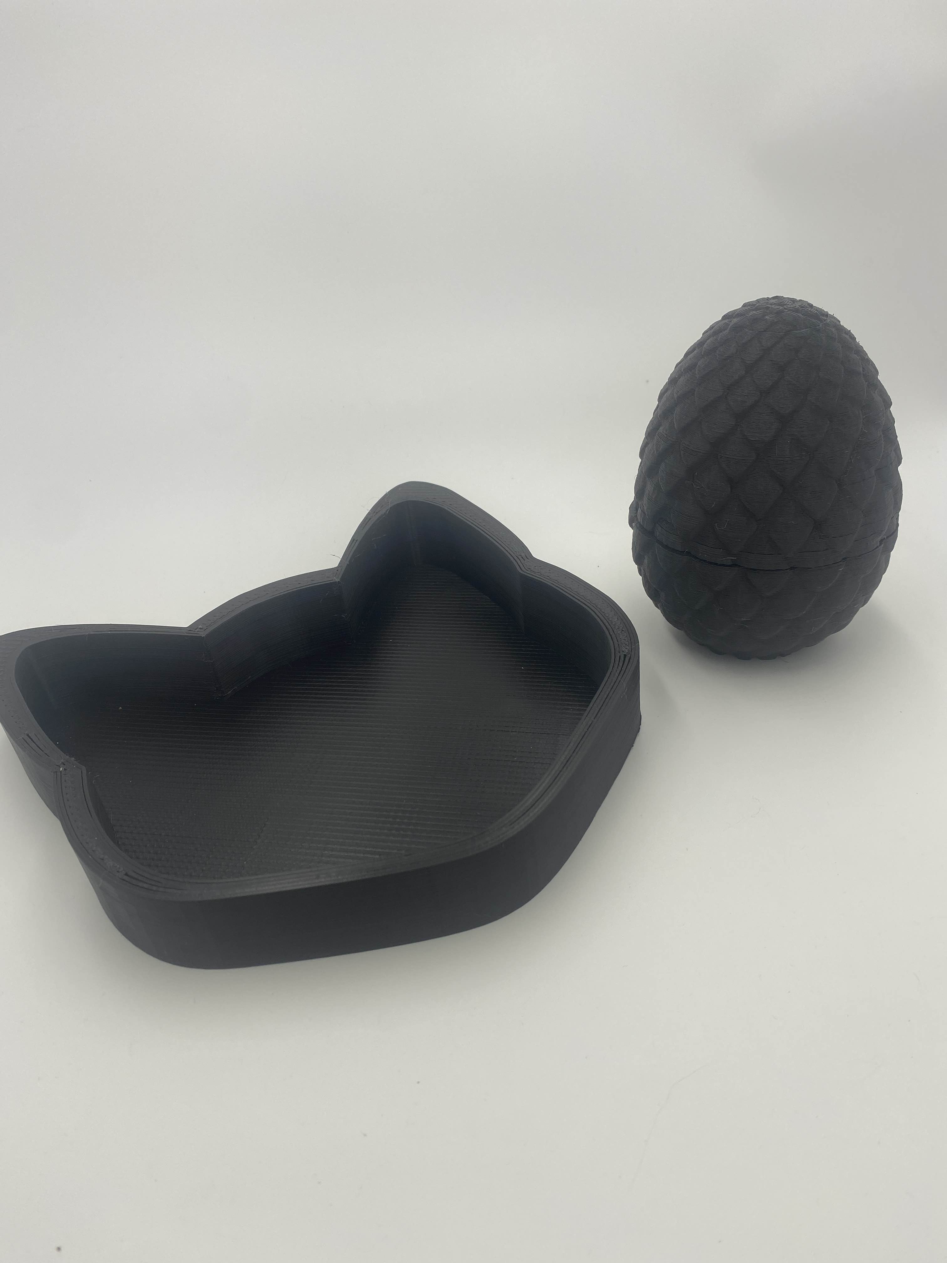

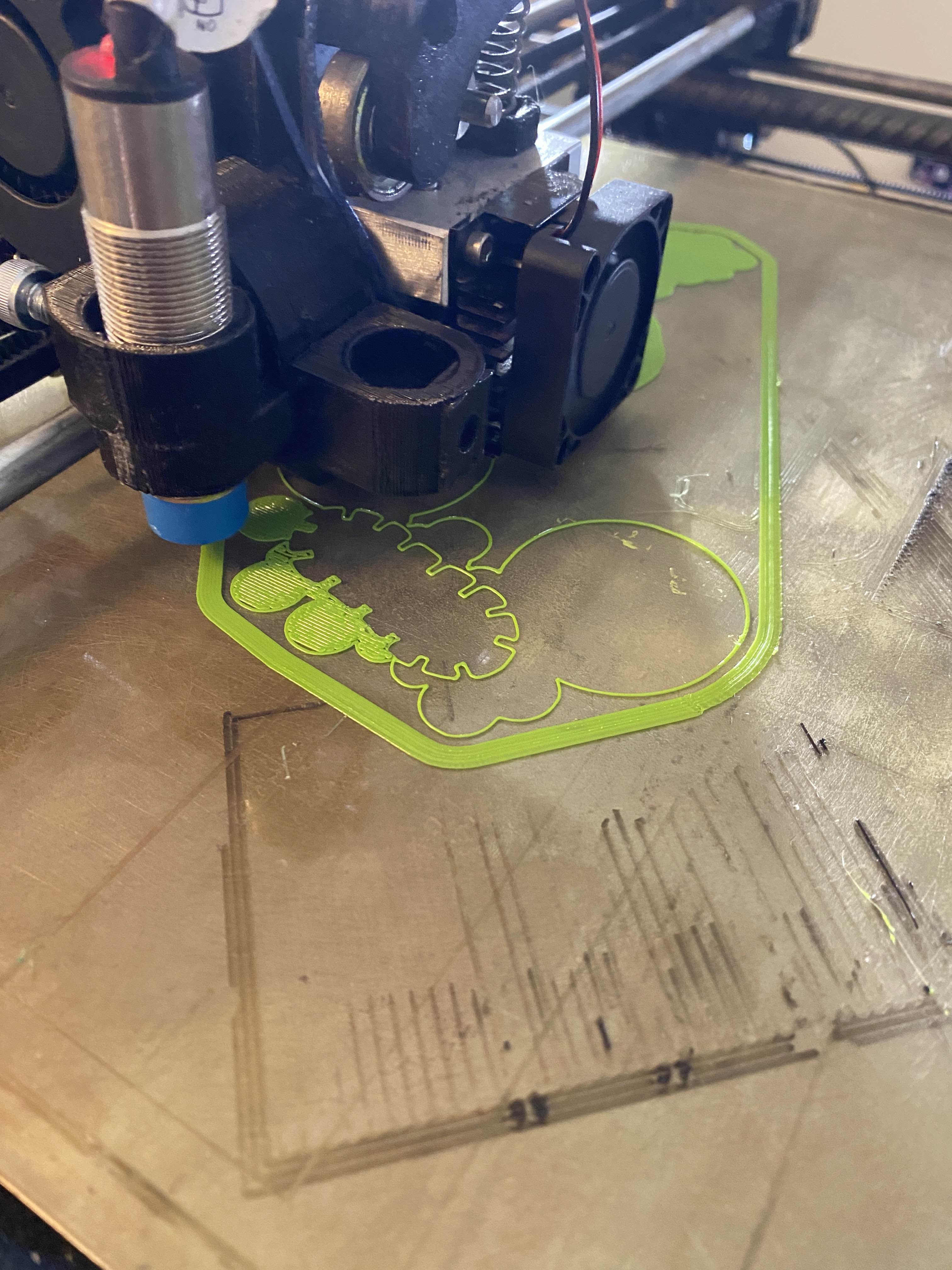

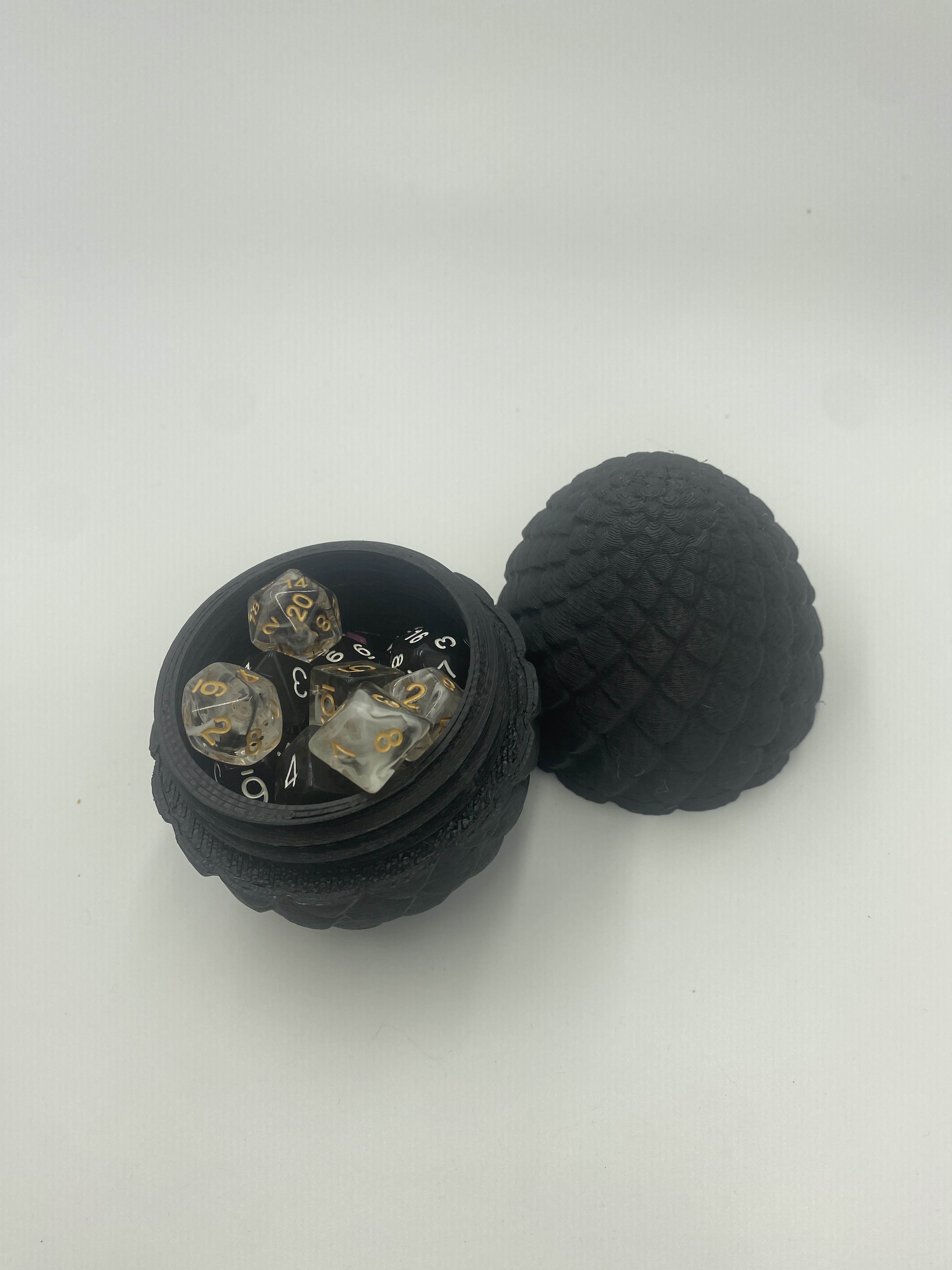

I have a few prints in the build pictures and video that show off the quality

Didn’t use one! Marlin doesn’t support accelerometers. I printed test prints that displayed the resonant frequencies of the X and Y axes. Once I had those I printed another set of tests to see how much I had to dampen the vibrations. Once I plugged in the results the printer began to run very smoothly!

Documentation Update!! Check out the new docs for the D3D Pro 3D Printer: https://alexandrialittle.github.io/d3d-pro/ Please pop in and take a look!! I will be continuing to update this website with the most recent version of the printer's docs as I write them. The docs are a work in progress and are stored here on github: https://github.com/AlexandriaLittle/d3d-pro
