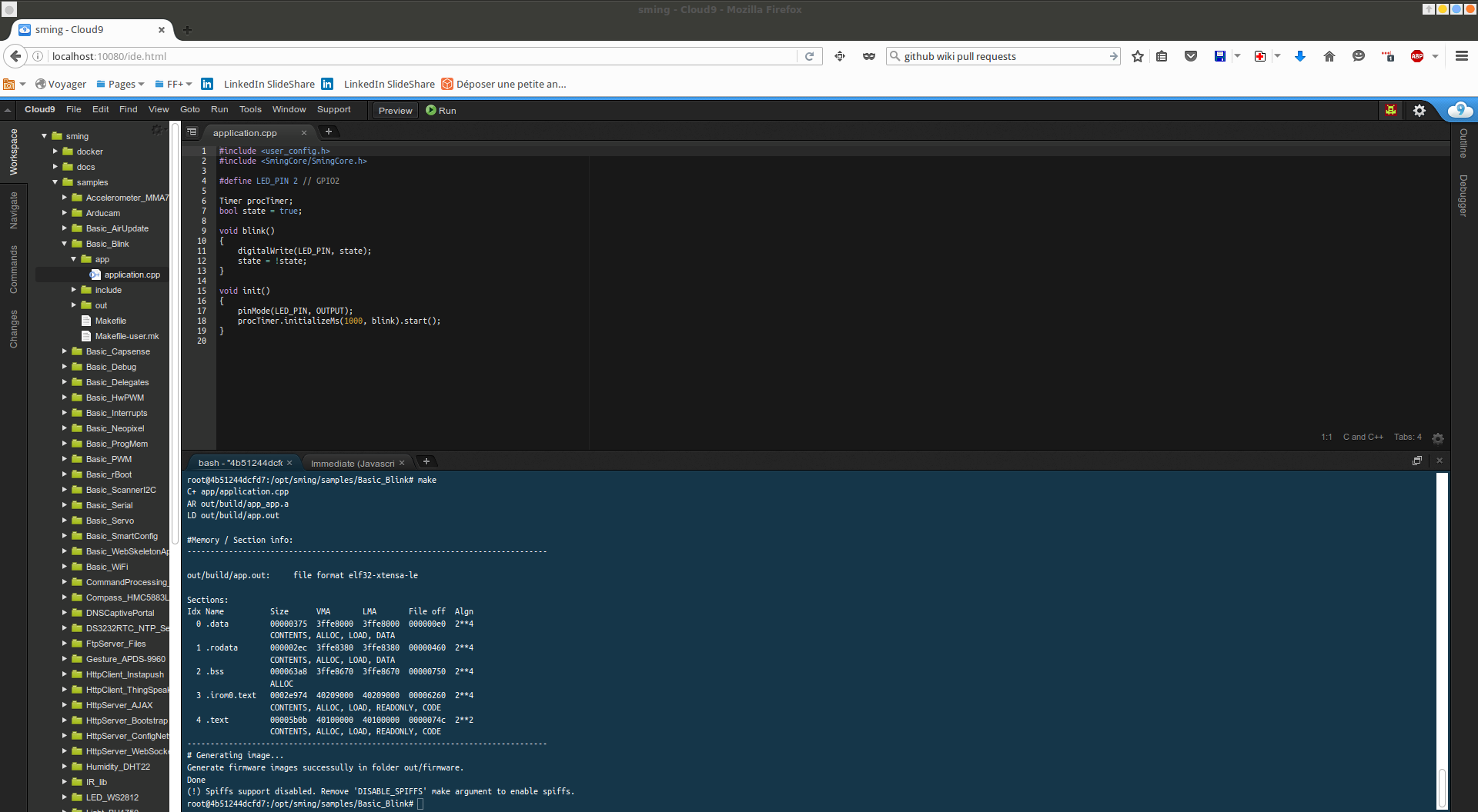

C9 screenshot example
And inside of the Terminal tab in your browser window you can type
cd $SMING_HOME
make
cd $SMING_HOME/../samples/Basic_Blink
make
make flash
