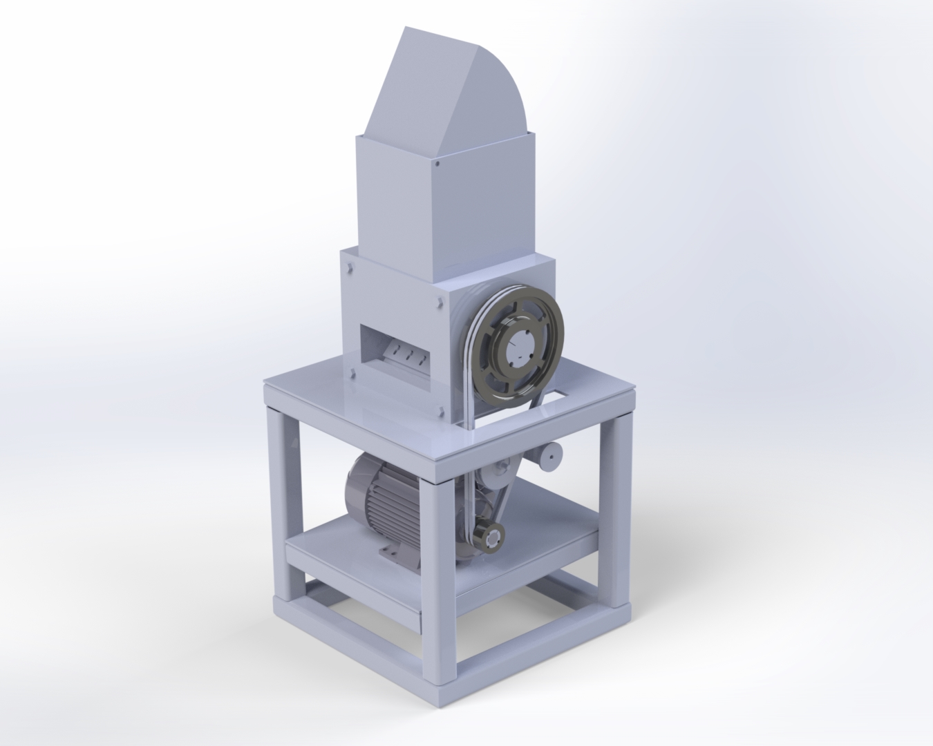

Grinder
Variants : Addon, Standalone, Asterix, IdeFix mini
This build can be applied to PP v3 shredders. It only needs a few steel bars and custom made grinder knifes
brief : General overview for a PET grinder
document scope : client, vendor, manufacturer
version : Rev-A
status : design & prototyping
license : open-source

Application: plastic bottles
NOMINAL PLASTIC CAPACITY: > 50 Kg/day
NUMBER OF ROTATING BLADES: 12
SPEED CUTTING: ˜ 350 rpm
NOMINAL PARTICLE SIZE: ˜ 6 mm
TOTAL DIMENSIONS: 600x860x1600 mm
TANK HOPPER DIMENSIONS: 300 X 300 mm
DIMENSIONS OF THE CRUSHING CHAMBER: 200 X 250 mm
IMPELLER DIAMETER: 200 mm
WASTE REDUCTION PLASTIC BOTTLES: 20:1
NOMINAL ELECTRICAL POWER: 2,2 KW
Files / Components
Constraints
- 6 mobile knifes | 2 stationary kifes - each adjustable
- v3 shredderbox * 0.3
- UFCL 205 bearings (shaft size : 30mm)
- dual pulley
- small footprint
- different sieves
- 220V/380V, 2Kw for now
- 400 - 700 RPM
- minimal height (eg: to enable it as addon)
- wheels
- Hopper with flake guide, door (flakes shoot really high)

Designs
(Source)
Components
Renderings
Variant : Large
Section View
