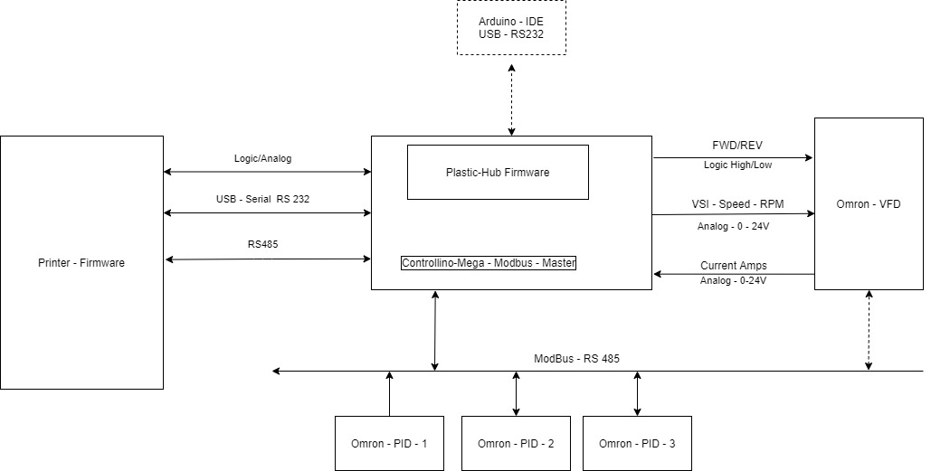

Firmware
(https://www.controllino.biz/product/controllino-mega/) which gives us Ethernet and RS485. The board has been proven reliable and robust (ideal for prototyping).
  • [-] VFD and PID control is mapped to Serial communication which might accept G-Code
  • VFD will be Omron-M2X series since we can use existing code. The VFD also supports Modbus (rather difficult)
  • Internal registers/coils (custom PlasticHub Firmware) to Modbus rep
Diagram source
PID Controller
  • We should go for Omron E5-C series which come with Modbus (consider EMI and cable length to the main controller)
  • Each PID will be exposed on the internal ModBus mapping
  • There is currently a custom PID controller in development but as mentioned, it's unlikely that it sees the light before November. However, I can imagine we use sub-routines as they're avaiable
  • [-] We should create logging module as well a an API to set temperature profiles for different materials. The logging module will help analyzing different PID settings as well experimenting with barrel cooling (when overshooting becomes an issue).
  • [-] Additional, we forward alarms for overshooting on the internal bus
  • Changes : Turns out that the E5DC / E5DC-B family is better choice.
