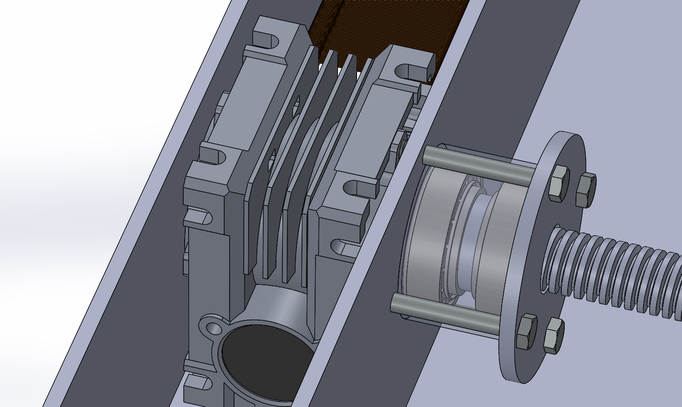

Motor: Nema 23 min 1.8Nm - preferably 3nm - £30-50
Gearbox: NMRV030 15:1 -£30-50
Driver: Pololu 36v4
Power supply: 48V DC

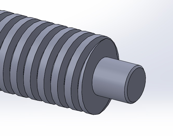

Leadscrew: Trapezoidal 20mm diameter 4mm pitch Accu
Driven end turned down to a plain 14mm shaft, with turned collar bushing welded in place
Screw collar exploded
Screw collar
The collar is located between a pair of tapered roller bearings inside a bearing housing
Bearing housing
Tapered roller bearings x2: 30204 j2/Q
At the other end, the screw is turned down to 10mm, to locate in a 6204 bearing with snap ring. screw other end
This will allow the screw to be installed by passing it out through the end hole and then back into the gearbox, inserting the end bearing and locating with the snap ring.

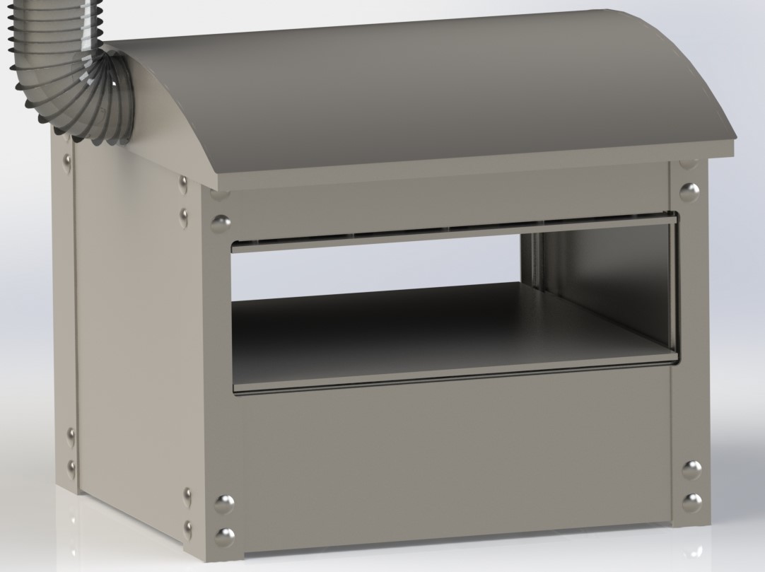

Extraction: via 125m tube to activated carbon filter
