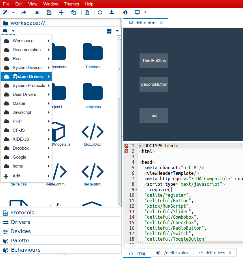

2.1 Files
All is based on files! In fact you don't need even the Control-Freak IDE, you can open all files with your preferred editor. The IDE will recognize file changes and updates all accordingly.
The file manager ("xamiro") is the most important interface of the IDE and it comes with powerful plugins and leaves almost no wishes open.
Remarks
  • Most key elements come with their own editors and interfaces but as "ControlFreak" uses only open standards and formats, you can always edit an item in its raw form. The file panel in the IDE allows you to quickly navigate to different locations such as drivers, themes, HTML files.
  • The file manager comes with a powerful text editor (ACE) and provides:
    • auto-completion (across all open files and items)
    • beautifiers to adjust intends
    • split views
    • a visual diff
  • The file manager also provides:
    • picture editor
    • drag'n drop upload into any panel
    • visual markdown editor
    • a batch language to have folder and file actions
    • a bash shell
    • an advanced logging
