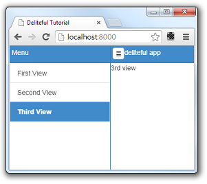

Note the on-selection-change="vs.show(event.newValue.id)" attribute on the d-list. It adds a event listener so that when an element is selected in the list, one of the children of the d-view-stack in the main view is shown:
Second View Third View
