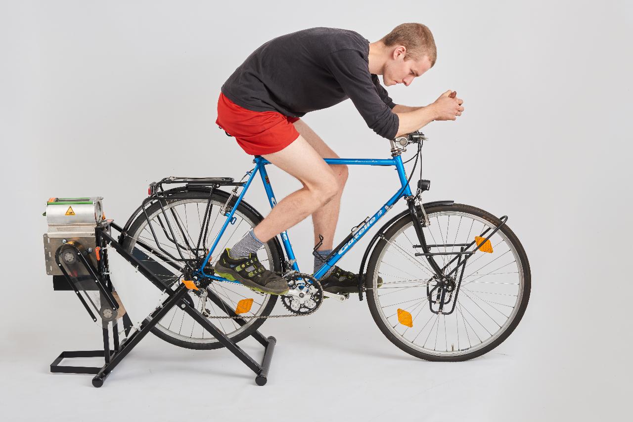

Bicycle Shredder V2 bicycle-shredder-v2 In this how-to were giving you an overview about the construction of our bicycle shredder. One and a half years ago we made the first video about how to build a bicycle shredder. Since then, we made further adjustments and are now proud to present you the second version of the machine (with a much better documentation).

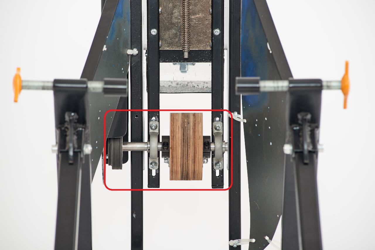

Step 5: Friction Wheel
The friction wheel transfers the speed from the rear wheel to the cutting mill. We use plywood for the wheel because we can mill it with our own cnc machine. Nethertheless there are definitely better materials for the friction wheel, for example something out of plastic.

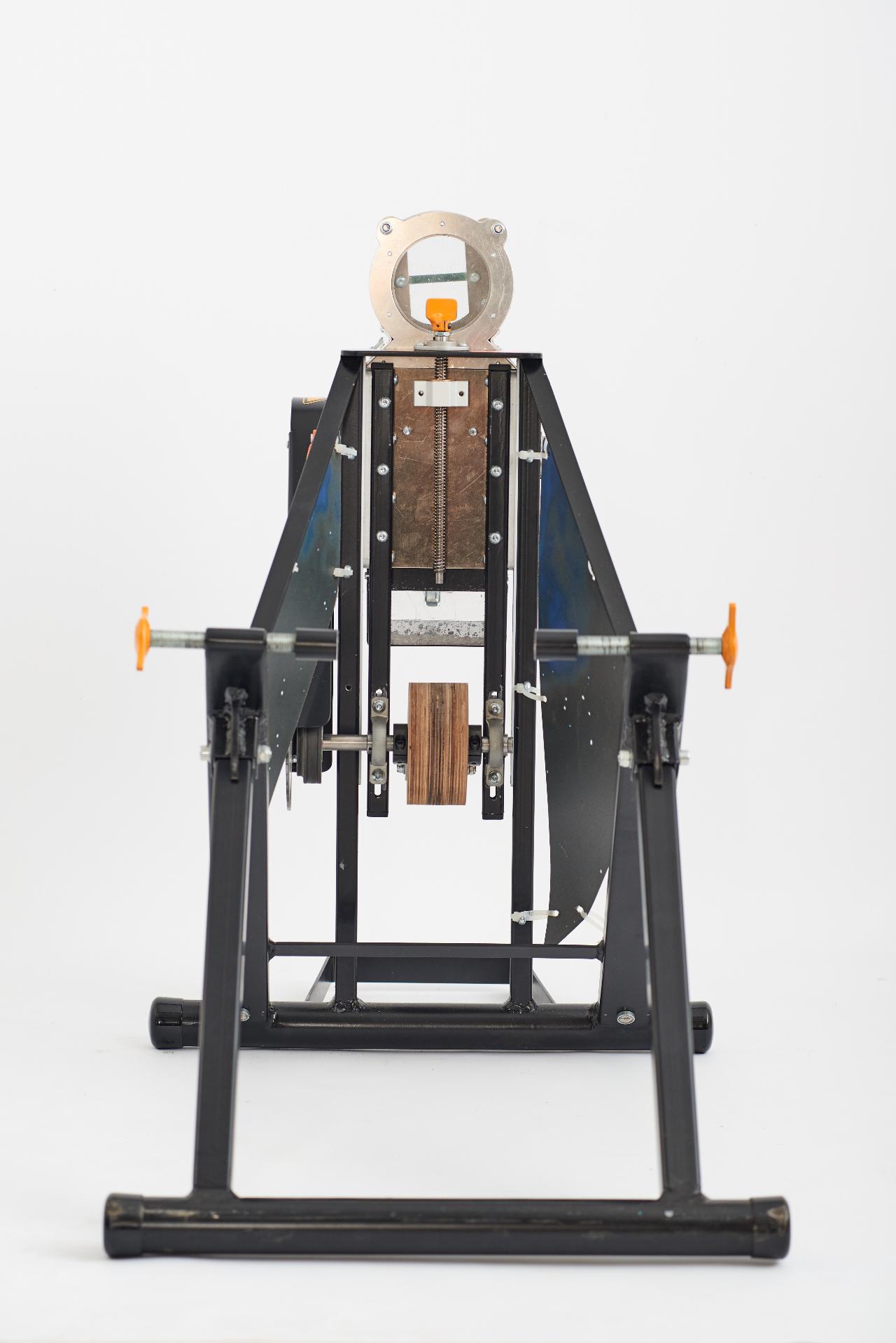

Step 6: Steel Frame
Building the steel frame requires proper knowledge and experience in welding and working with metal. If youre new in the game, look for someone with experience in metalwork.To simplify the welding process we prepared gauges -> plywood sheets to keep the right distances between the steel tubes and some big 45° angles.
Before welding everything make sure everything is drilled and milled into the steel tubes. Afterwards it's a bit tricky to get them to the right places!

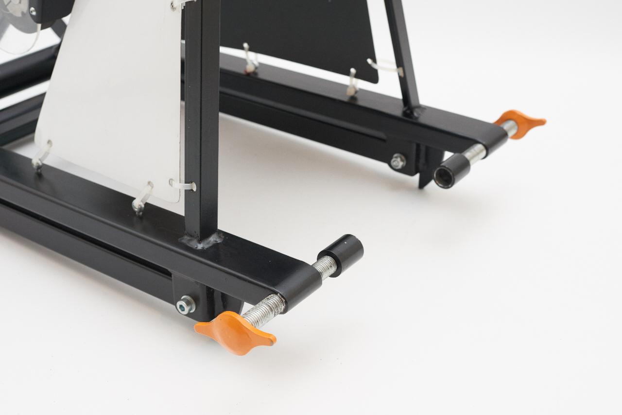

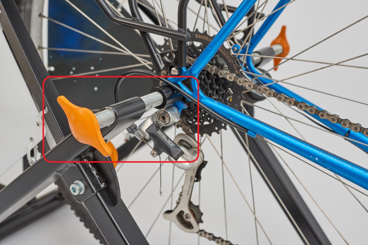

Another advice: welding the m16 nuts; make sure the two nuts are in one alignment. That's important to clamp the rear-wheel right in place. We take a long steel bar (14mm in diameter).

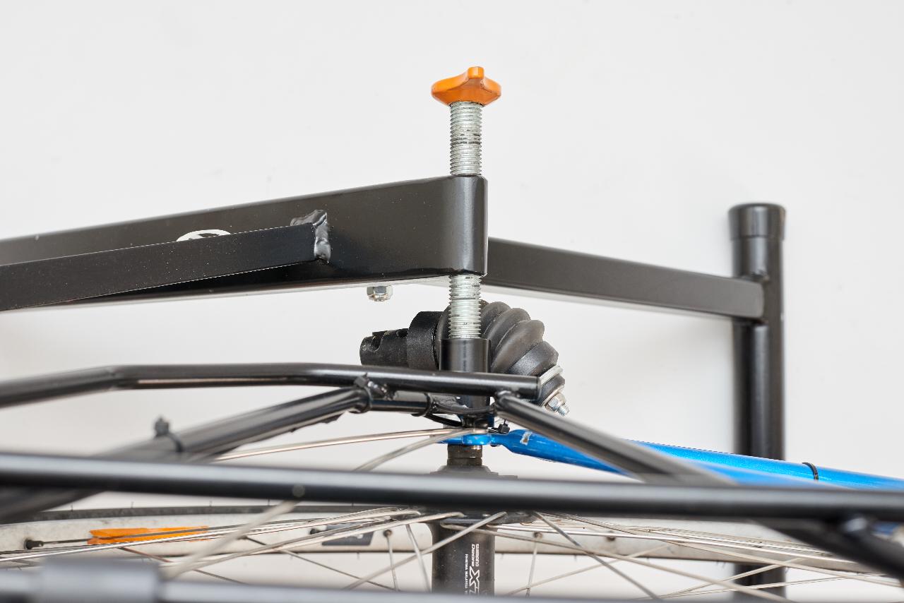

Step 7: Height Adjustment
The height adjustment is one of the fastest things you can realise :-). For the turning knob we welded a small steel strip on a clamping ring. The rest of it are just ready-to-use standard parts.

Step 8: Wheel Mount
The wheel-mount is a lot of lathe work but not too complex! For the turning knob we lasered a part out of a thick metal sheet and welded it on a nut. Instead of a lasered part you can realise the turning knob as well by some steel strips and an angle grinder.
