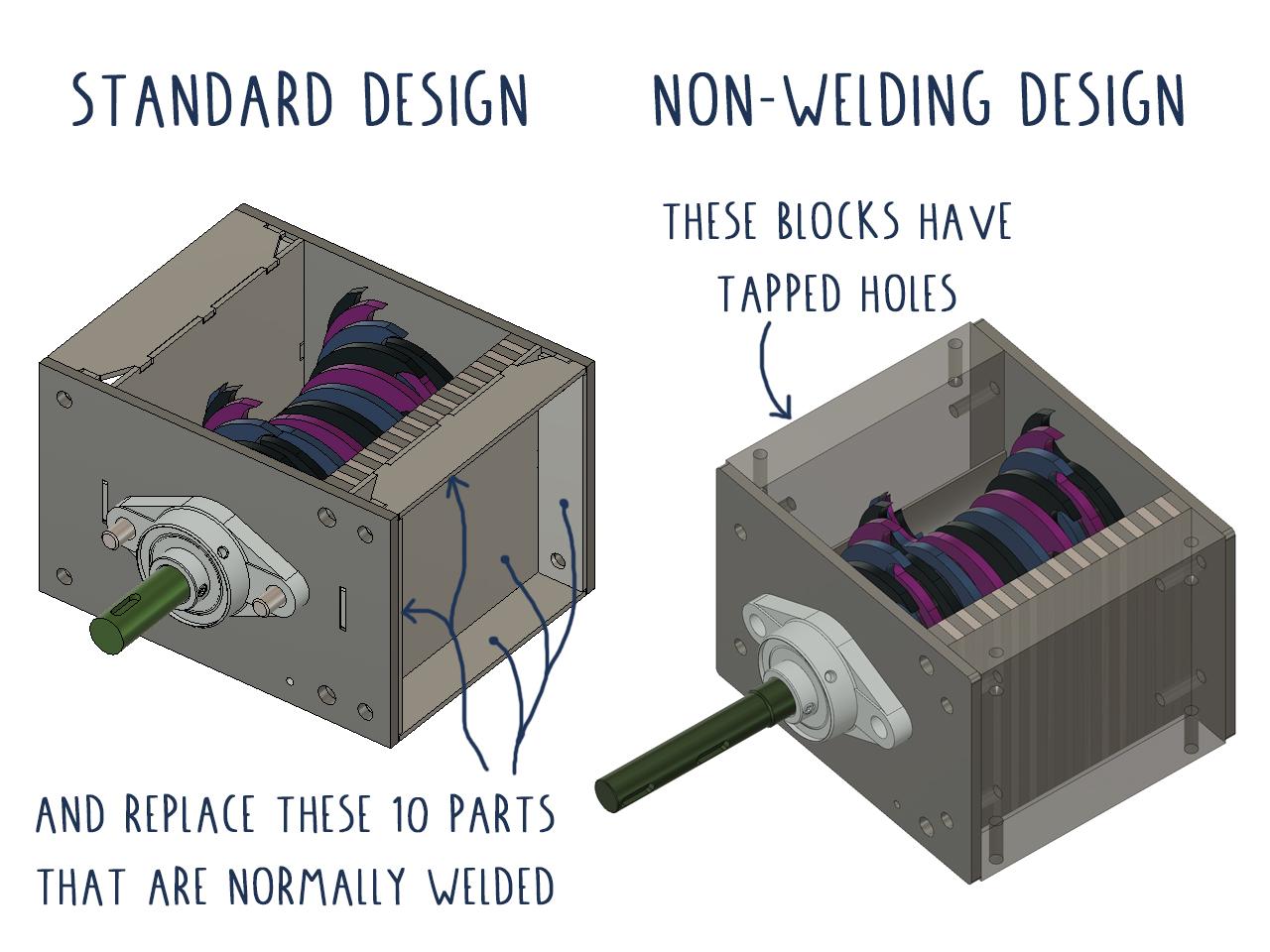

Step 3: To weld or not to weld
If you can't weld steel, or don't have access to it, there are other techniques that you can use for the frame:
  • Steel sections can be fastened with nuts and bolts. You save the welding time, but need to drill holes instead.
  • You can use aluminium extrusion T-slot profiles instead, which are easy to bolt and work with.
  • Be careful if you use wood as an structural element. Some parts of the shredder may be subject to strong forces that wood may not resist.
As for the shredder itself, it can be modified so that it doesn't need welding, but would require a different technique: precision engineering (holes and dimensions need to be very accurate and perfectly square)

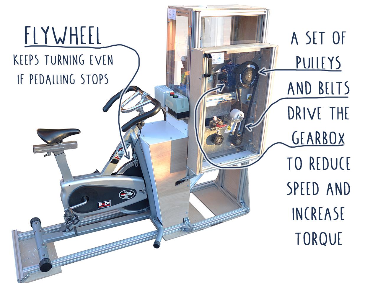

Step 5: I believe I can FLYWHEEL
The magic of the flywheels is that it gives the machine inertia: When it's turning, it keeps the machine moving with little input. Remember to put it on the 'fast' side of your mechanism.
The factors that influence the efficiency of the flywheel is its weight, shape and speed. Usually a disc or wheel works best, a distribution of weight away from the axis helps. The faster it moves, the better it is at mantaining rotation with little effort.
Think of the exercise bike in the picture: the flywheel on the front will keep turning even if you're not pedalling.
