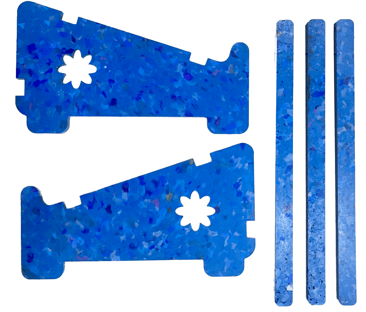

Step 2: File in the CNC machine
Use the file converted to the cnc machine.
  • Take into account the diameter of the cnc milling cutter so the dimmensions of the parts do not change. -Make sure to vacuum the microplastics in order to be able to transform them again into plastic sheets ( we usually use this kind to prototype new products )

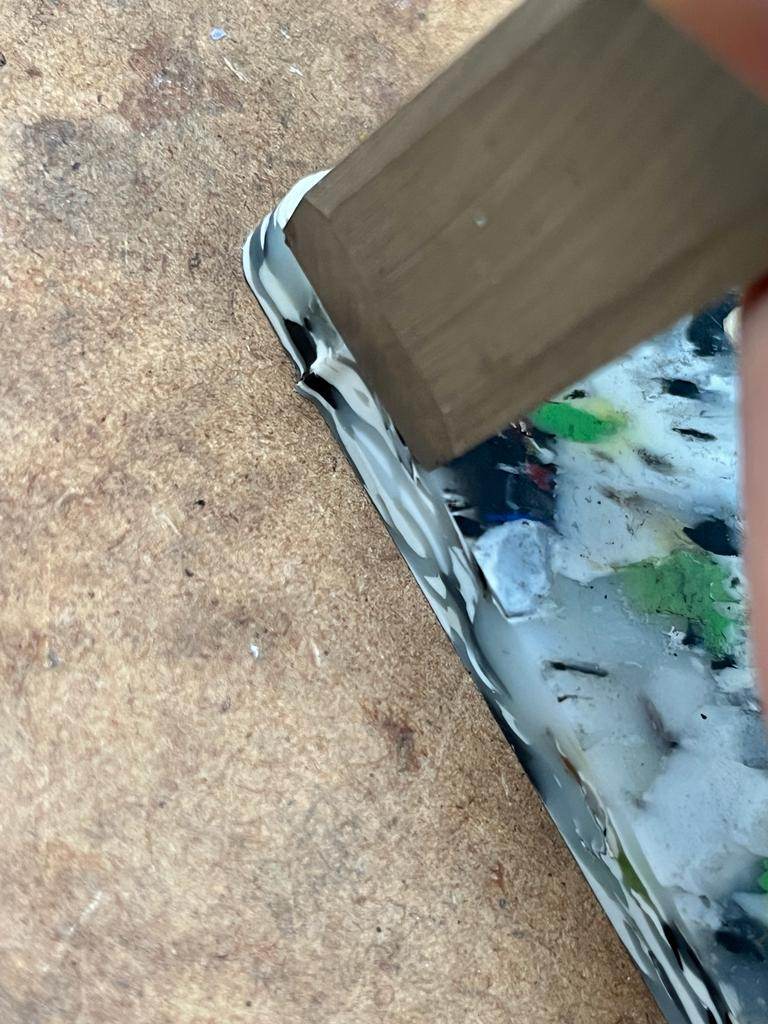

Step 3: Soften the edges
The cnc machine leaves a support, now its time to get rid off it with the chisel, and after that we can soften the edges with the sandpaper.
