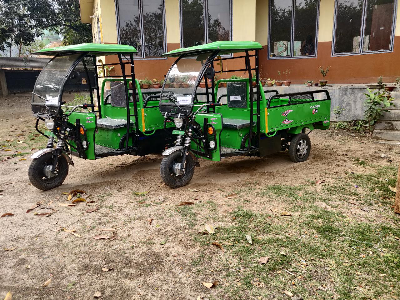

  1. Selecting the right vehicle for the project that can fit all your machines and can handle their weight.
  2. Considering a stable platform during the operations
  3. Strong and stable chassis to bear the weight and can abrobe the vibration in terms of shredder
We selected an electrical Vehicle as it will reduce the carbon footprint and can also be customized according to our requirements.
We tried designing in a way where we can increase the working area and can also add a foldable roof that will further help during the bad weather.
We have a working area of 8 x 7 feet and we tried to install 2 machines in it. We had 2 vehicles so we managed to put shredder, injection and Extrusion.

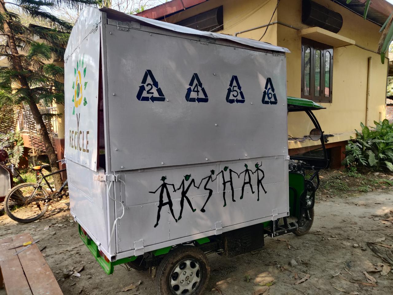

Step 2: Making the body of the unit
We started with the outer body of the unit as we have few constrians like weight, size and durability.
First we made a frame with metal tubes and then started covering it with metal sheets.
We tried to keep the base more stable and stong as people will be standing on it while working on the machines.
Roof height is adjutable up to 7 feet and could be lower to 4.5 feet. Roof side is made with pannels
Roofing is done with metal tube and fiber sheets as we have weight limitations with the whole system.
We added a wooden base as a flooring and painted everything nicely.

Shredder was the heavier, so it we placed a single shredder on one vehicle due to overall weight distribution.
On another vehicle we placed Extrusion and Injection machine keeping some space in between to work safely and easily on the setup.

After installation we did a test run to check the working of the machine. Tested the stability of the overall setup and also added some supporting structures around the vehicle.
