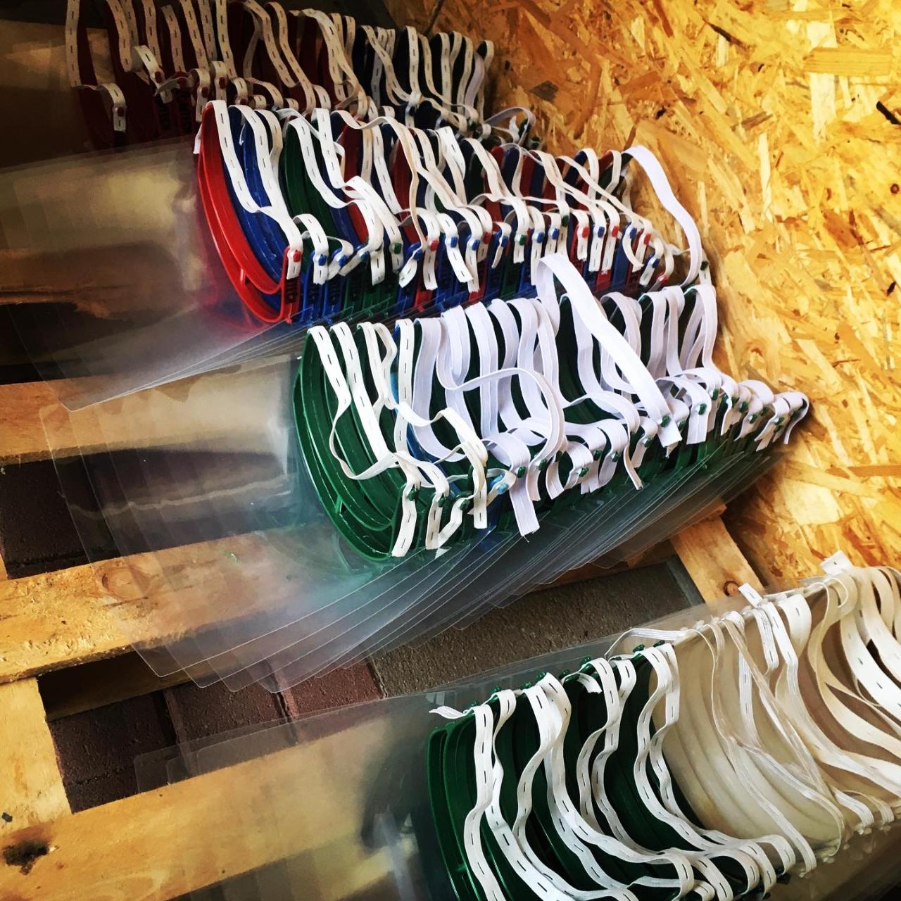

We started 3D-Printing face shields a while ago, but we couldn´t keep up with the demand. So we built a small injection machine to speed up production. Though we had to wait 7-8 minutes bevor we could make another face shield frame, because the plastic flakes had to heat up.
To reduce the time-per-part we invented the Rapid-Fire-Method. Using our extruder we produce hot munition for the injection and instantly process it.

Now place the mold under your injection machine and inject the melted plastic. In this case, we are using the professional mold for face shields from Plastic Preneur (a cool company from Austria). In order to achieve maximum efficiency, we have one person reload the injection machine, while the other person opens & closes the mold. This way, we achieve a cycle of about 2 minutes per part.
