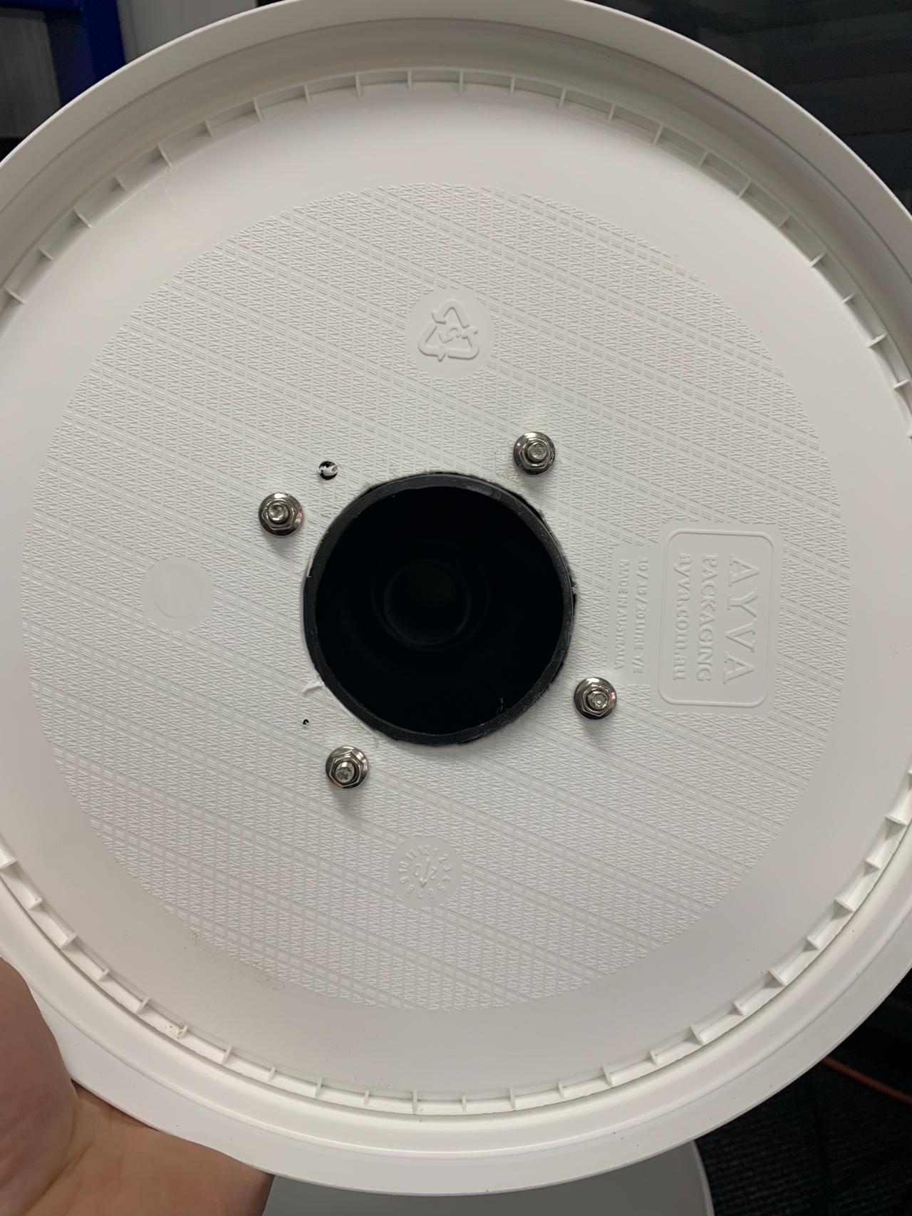

Step 3: Dust Cyclone
Dust cyclones remove over 99% of dust and debris from the airstream, containing it before it ever reaches the vacuum. We've been running our Dust Extractor for quiet a while, and are yet to spot even a speck of plastic in our vacuum.
The cyclone will include a cutting template and instructions, along with nuts/bolts and connection pieces. We picked one up from eBay for around $40AUD: bit.ly: bit.ly/3iKR4e6

Cyclone: • Place the template (included with cyclone) in the middle of the lid • Mark and drill the bolt holes • Mark and cut centre hole • Connect the cyclone using the nuts and bolts provided (see images in Step 3)
