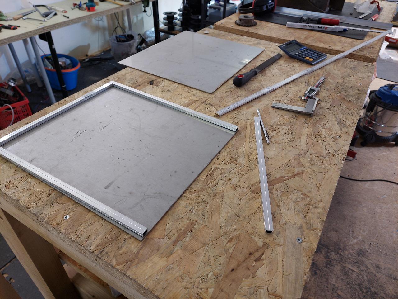

Step 1: Cut the raw material
You will need two galvanized metal sheets and Aluminium profiles for the frame
Material: 2 pcs 350x400x3mm galvanized metal sheet 2pcs 12,5x7,5x400mm Aluminium Profile 2pcs 12,5x7,5x325mm Aluminium Profile
Tools: Saw or flex
ToDo:
Sheets: Normally, you can buy metal sheets in the right dimension. Otherwise you need to mark the dimensions on a bigger one and make a cut out. We use a flex for the cutting but it is also possible to use another kind of saw
Frame: Mark the right length on the profile an cut it by using a saw.

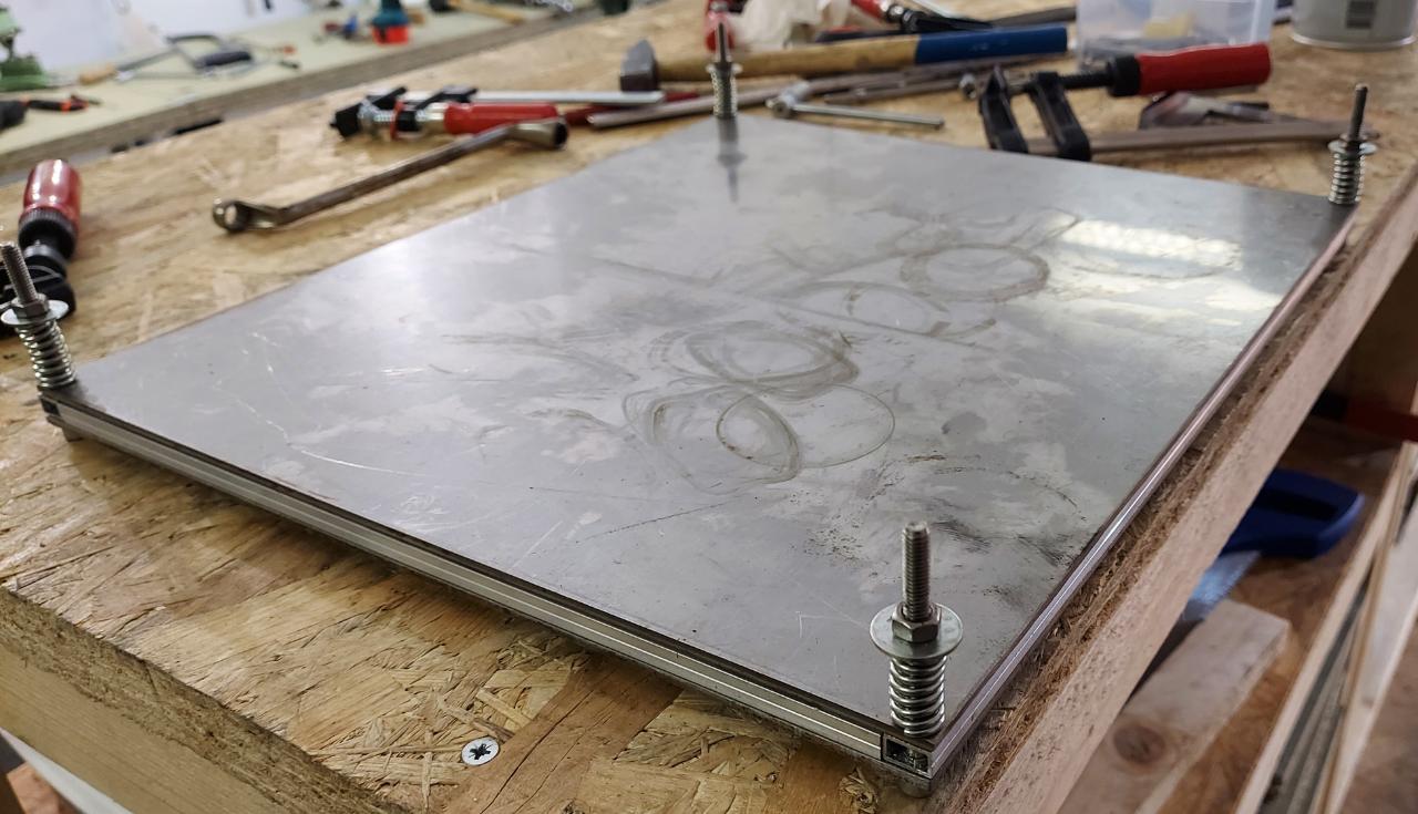

Place the second metal sheet on the framing and align them for perfect fit. Fixate everything with screw-clamps. Drill one hole in every corner. Instead of holes, it is also possible to saw a cutout which makes the assembly / disassembly oft he compression screws faster.
Step 5: First testrun
The mould is finished so far, let’s test it.
Material: Mould; small Plastic-Granulate or Pellets, Silicone-oil spray; oven, M6 Screw, washers, compression spring
ToDo:
Give the inside oft he mould a slightly silicone oil cover by spraying a small amount on the top and bottom. Fill the plastic into the mould and place the cover on the top. Then place the compessions screws in the cut out and tension the spring by screwing. Place the mold in the oven and choose the temperature depending on your plastic. If you don’t know the right temperature, start with 200degree and change it in the next run depending on the outcome. 1,5h baking time is also a good starting point.

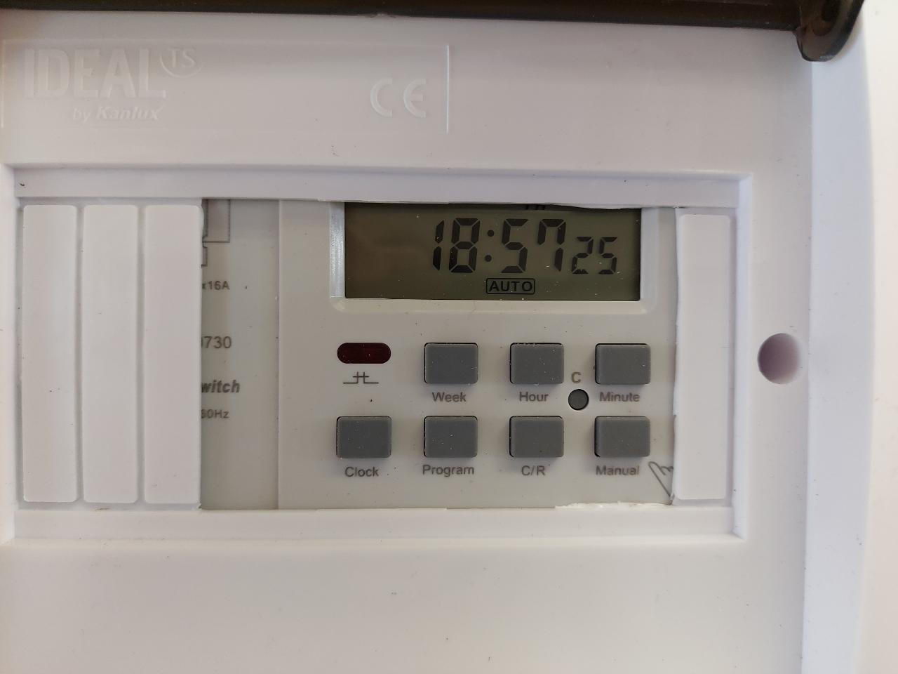

Step 6: semi-auto mass production
To make one sheet with the oven is nice, but it is possible to make a few more in parallel. So you can build a few more moulds an place them all together in the oven. If you don’t want to wait until the baking process is finished, you can also add a timer which switches the oven off automatically.
Material: 4 pcs. Oven Molds, Timer, Oven-rack(optional)
Tools: Screw Driver
ToDo:
Prepare all four moulds like shown in step 5. Stack them in the oven and start the baking process. Be aware of the baking time which normally goes up because of the higher thermal mass in the oven. Start the timer. The oven process now runs automatically with no need of a human for switching off

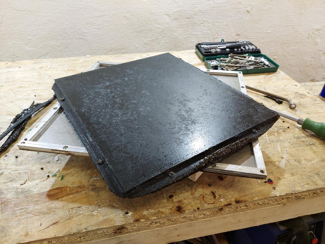

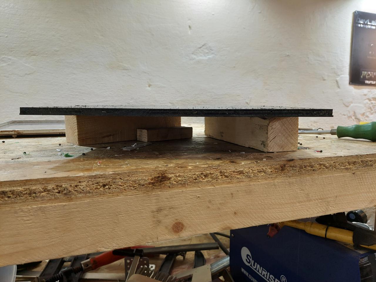

Step 8: Results
Here are some pictures of a sheet made out of ABS. If you compare it with the simplicity of the process, the outcome is really great. After cutting the edges, you will get a flat sheet with good surface. (small pellets / flakes work best)
So, try the process yourself. Play around with it, hack it and if you find even a better / simpler way to produce sheets, share it with the community by making a How-to
