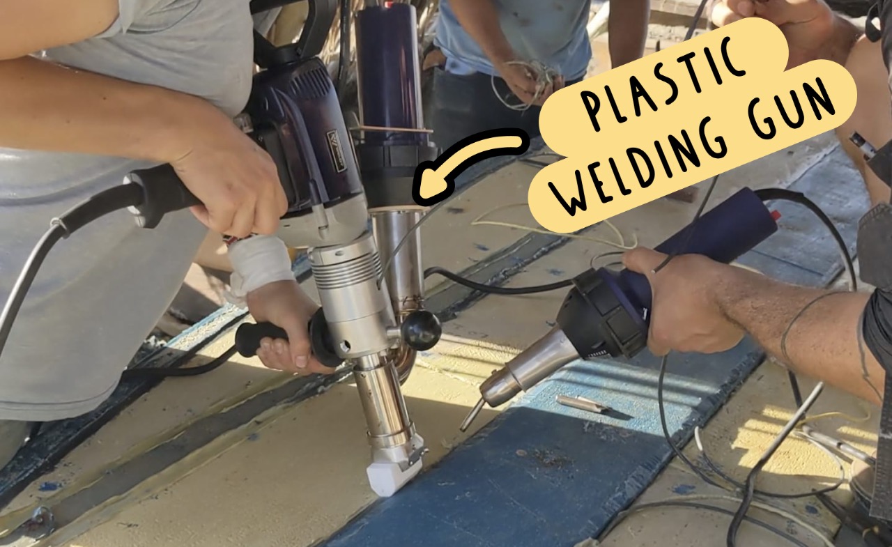

In this video we show you:
  • the equipment that can be used for plastic welding and how it works
  • how to make a "sandwich plank" (a big beam out of normal plastic planks)
  • how to make a T-profile
  • how to seal gaps of a boat hull
Step 2: Try it yourself!
There is so many more things you could do with this technique - let your creativity flow!
You can try this technique in a low-tech way with a conventional heat gun,
  • or maybe you even get the professional tool,
  • OR maybe you can even come up with a modification for a heatgun to do it more professionally? Let us know!
