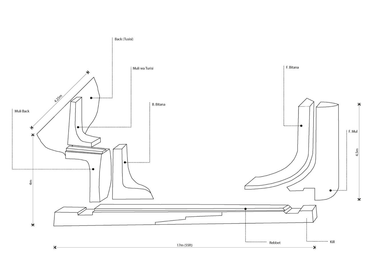

Step 3: Make a plan
With Ali Skanda we made a plan and designed the boat, to get an idea of the required components and joineries.
The goal originally was (and still is), to build a boat which would be big enough to travel the message to fight single-use plastic and plastic pollution around the world.
Here some of the sketches to get an overview of the parts.

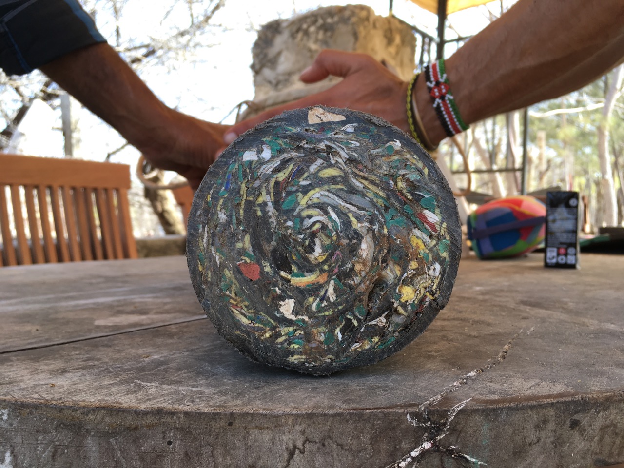

As the approach was to have everything made locally in Kenya, a big challenge was (still is) to find collaborations with recycling manufacturers who deliver quality materials, reliably.
We started at at point where they were mixing plastic types together or even add sawdust or sand (as a “stiffener”) and its already a success to have them working with only one type of plastic, without anything else mixed in. Part of this was getting material samples and testing joineries which would be used in the boat.
Starting with samples can save you a lot of time and costs, before ordering a bigger amount of materials.

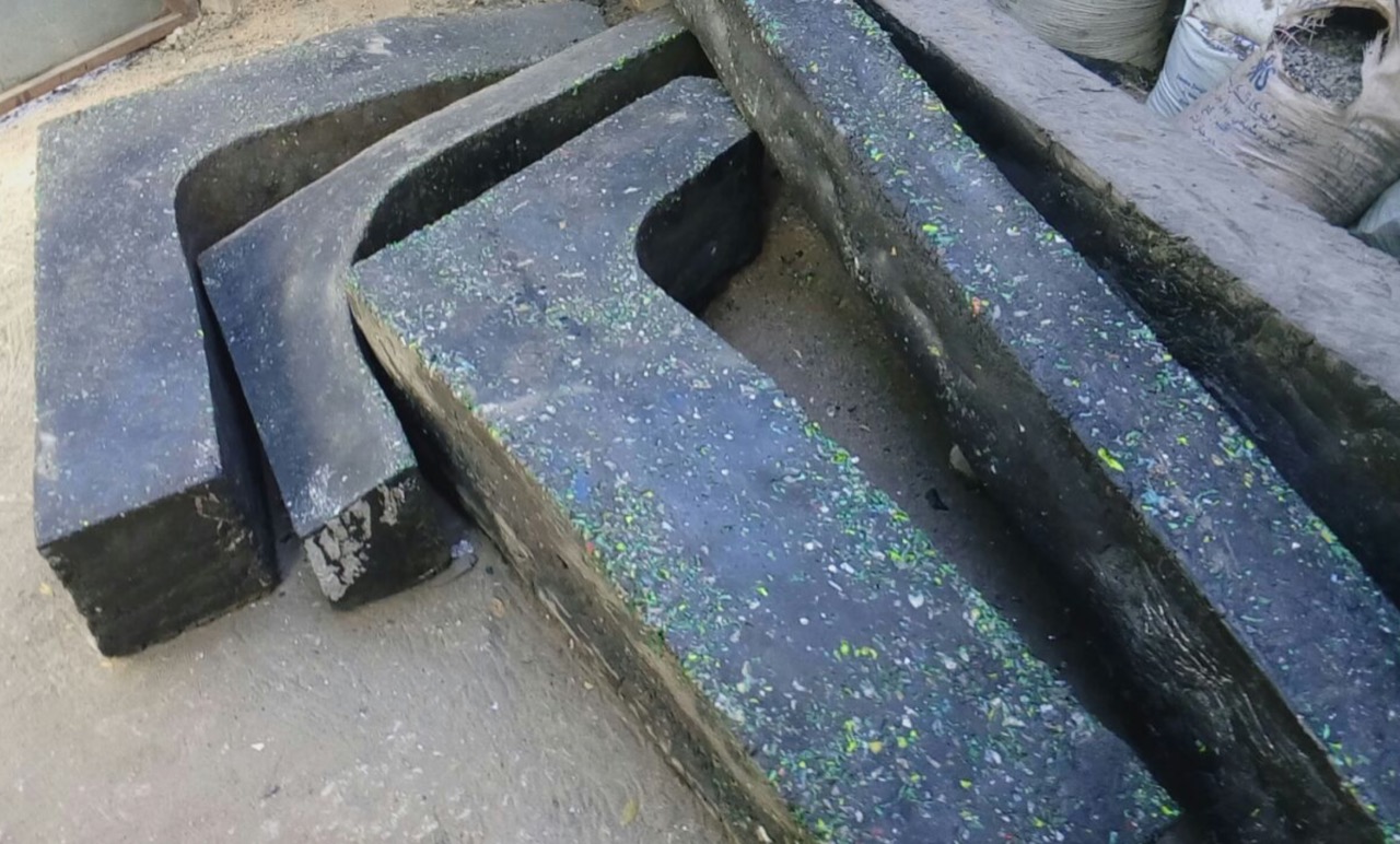

The production of the BIG PARTS like keel and ribs was one of the biggest challenges. We managed to work with what we could get, with a lot of space for improvements!
We collaborated with the closest plastic recycling manufacturer Regeneration Africa in Malindi, where they usually produce fencing posts and tiles.
Here is an overview of their process. (second image). We made over 30 metal moulds for different boat parts which were filled this way, using HDPE which is the most common and easiest type to collect separately (after PET).
Sam and his team were a huge help to explore and figure out different processes and materials!

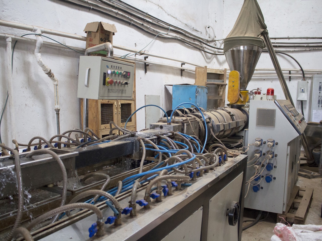

It's a quite common practice there to mix in sawdust to make the material stiffer and cheaper to produce (but that material mix also breaks much easier than pure plastic). It took a couple of attempts, but in the end we managed to get the 100% recycled plastic planks.
These planks were produced with professional, industrial machines, but could definitely be made with the [filtered] Extrusion Pro as well! (Extrusion Pro:

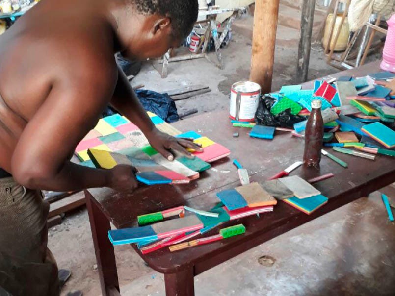

Step 8: The flip-flop sheets
40% of all the waste collected on the beaches were flip-flops. This is where the project got its name from and why flip-flops were an obligatory element of this boat.
So we covered the whole boat with sheets of recycled flip-flops, giving it a very colourful look and adding an extra protective layer (the whole boat feels like a big yoga mat :))
The sheets were made by local flipflop artist James who cuts the flip-flops into pieces, glues them together and sands them to an even sheet.

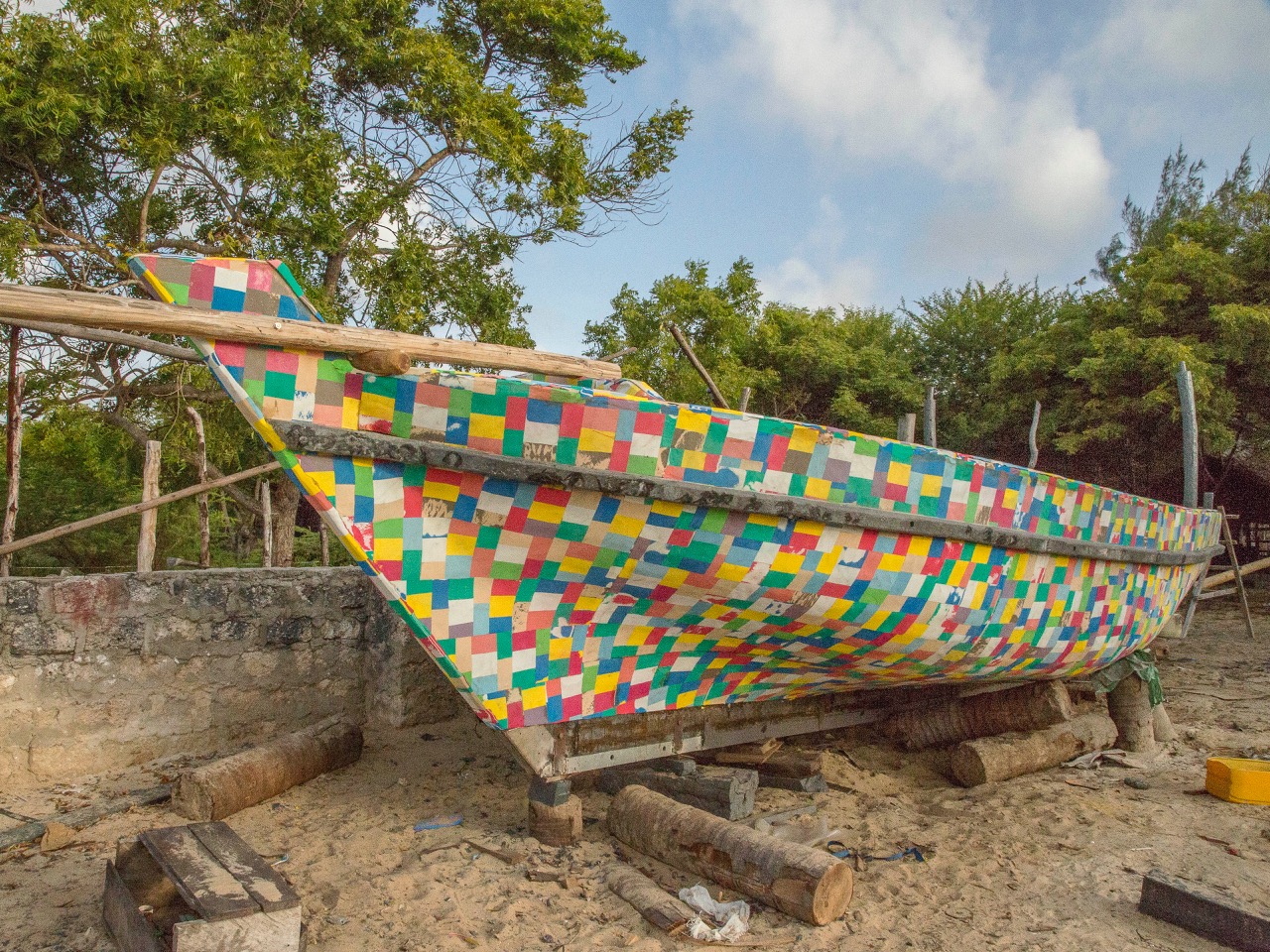

Time to build the boat! Starting with the keel, the ribs and connection parts, then making the hull with the extruded planks, and finishing with the colourful Flipflop sheets.
Other than using this new material, the boatbuilders made the boat in their traditional way, meaning that they used very basic tools (every screw was inserted with a hand drill and a screwdriver!).
This is obviously something we won't be able to teach you here - that's what you need a boatbuilder for! :)

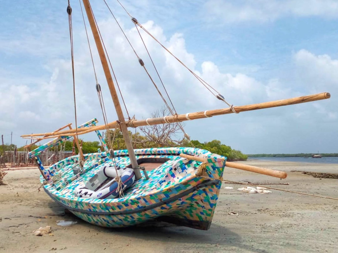

Alright, now we only had to add (second hand) parts from other sailing boats like the mast, boom, sail and ropes. And were finally ready to do what the boat was meant to be for: Sailing around Kenya to create awareness around the problem and inspire local communities to be part of a positive change!
On our first expedition the boat sailed smoothly for more than 500km from the north of Kenya to Zanzibar, carried its passengers safely while creating excitement and fascination everywhere we went!
IMPORTANT: Definitely test and check your boat if it's seaworthy! You'll be responsible for your passengers and yourself, and don't want to risk your lives 🙏
