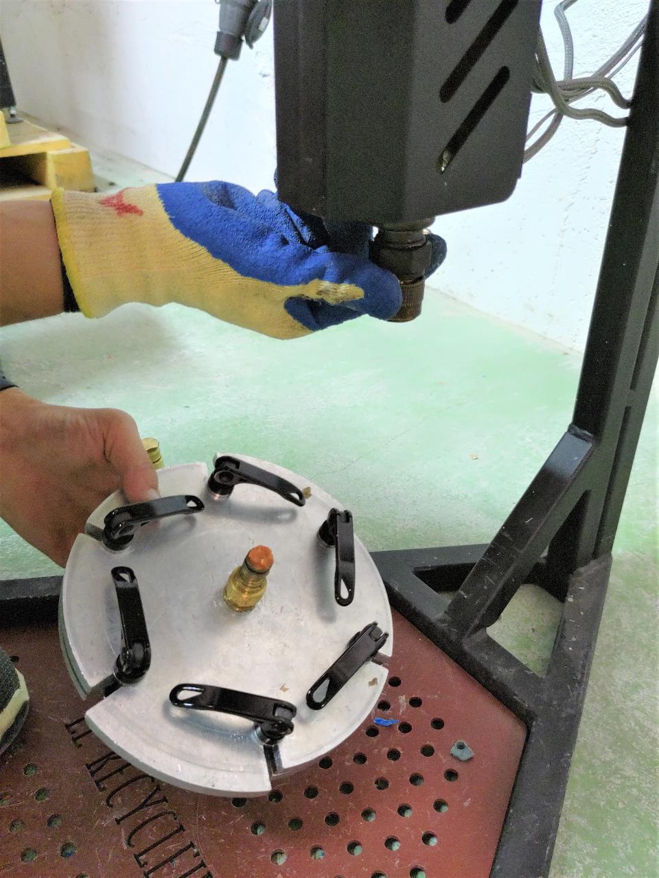

Step 5: Instructions for operation
1 - Prepare your mold as usual and heat up your machine
2- When you are ready to inject, remove the plug by simply lifting the female connector exterior ring (picture n°2)
3-Push your mold up into the connector, it will automatically latch onto it and make a nice "click" sound
4- Inject your mold
5- To remove the mold, just lift the female connector exterior ring and get your mold, then place the plug back inside.
6-Repeat :)
Using this method, I was able to pull out about 15 injections/ hour, which is way more than I used to.
