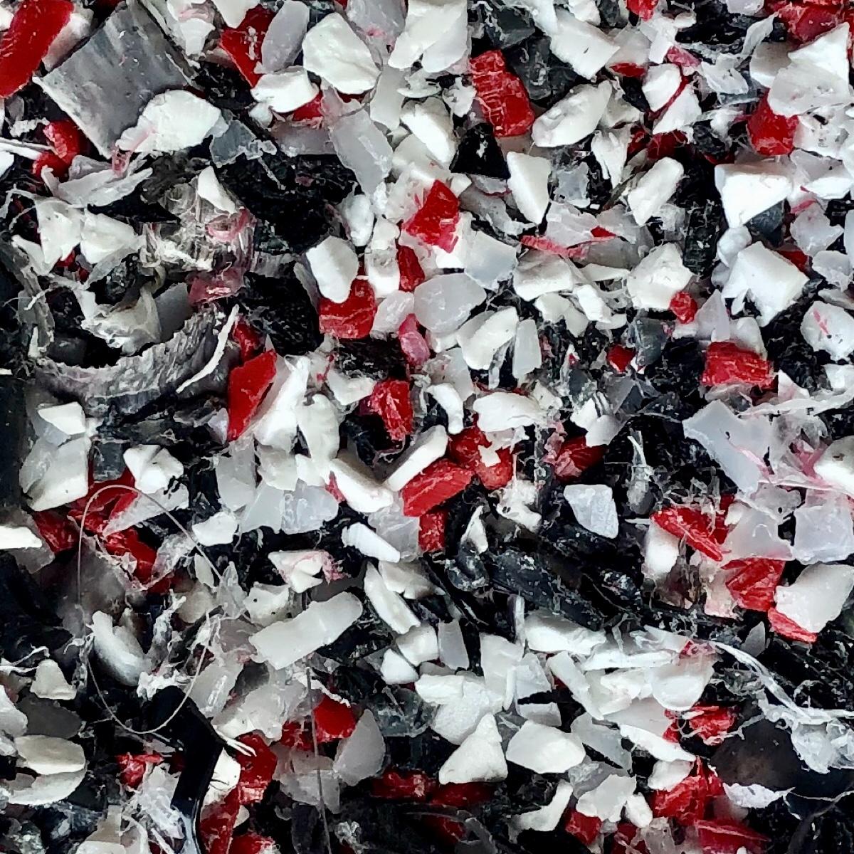

Collect used plastic to shred and shred it, or buy pre-shredded plastic:
(Ive found that type #2 HDPE has worked best for me for durability and boardsliding, but Id love to hear what other people find if another plastic type works better/differently for them)
