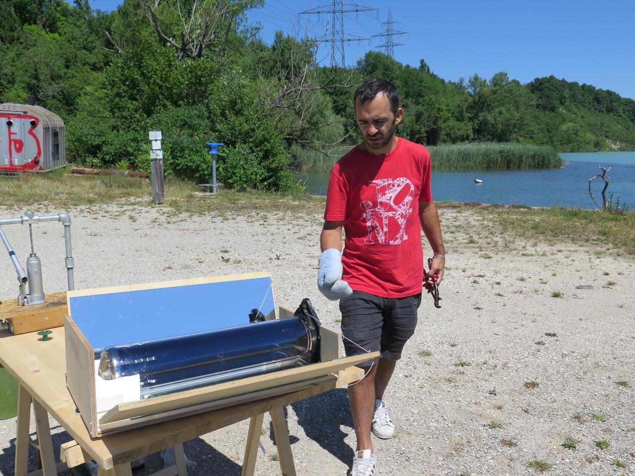

Find a sunny place and preheat the solar tube concentrator
Step 2: Load the cartridge
Load the shredded plastic inside the iron cartridge.
Compress as much as you can the needed amount of plastic depending on the volume of your part, inside the cartridge.
Lock the plumbing pipe with ½" of cap ends.
Load the cartridge inside the solar concentrator.
Step 3: Heating the Cartridge
Wait the time necessary depending on the sunlight exposure (between 30 and 60 min).
You can load several iron cartridge inside the solar concentrator to speed up the process.
Use a temp prob inside of the heated tube to manage the temperature of the cartridge.
The concentrator can heat up between 180-250°C.

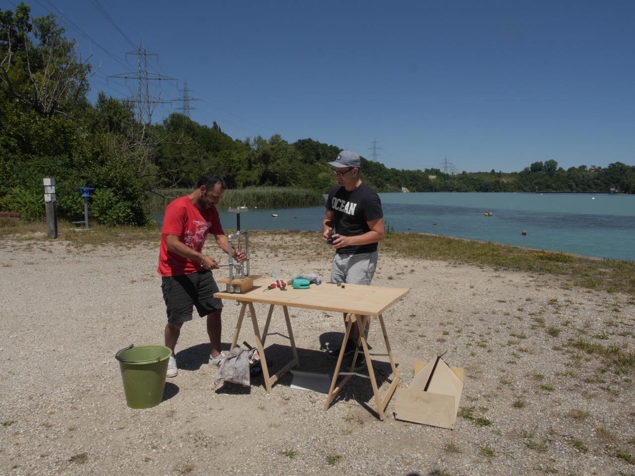

Step 4: Screw cartridge & mold
The cartridge will be really hot, USE GLOVES !
Remove the two cap ends of the hot cartridge.
Plunge one extremity of the tube in the cup of water.
By putting the end of the tube in the water, you will make a hard plastic piece that will push the melted plastic inside of the mold.
NB : Preheating the mold above 60°C helps a lot to obtain a nice finished part. The preheating is easily achieved by putting the mold a few minutes in the solar concentrator.

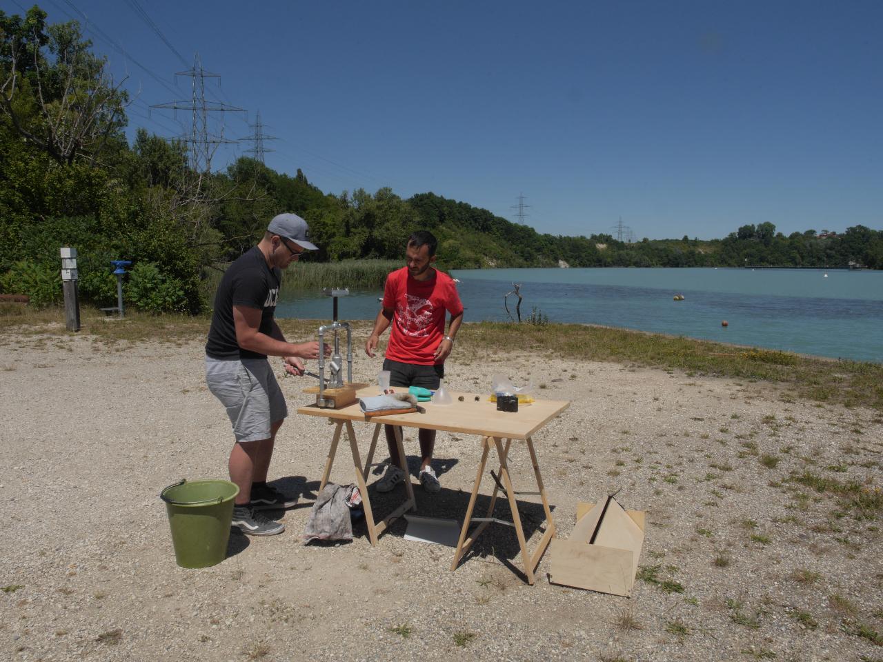

Step 5: Inject manually
Inject the plastic inside the mold, the quicker you can, the better it is.
We will share how to build our portable hydraulic jack press next time.

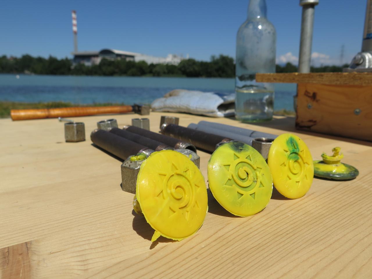

Step 6: Extract the injected part
Be sure to have cooled down the mold (if needed you can put it in cold water) before extracting your injected part.
Now you have a nicely injected finished part made only with human and solar power !
