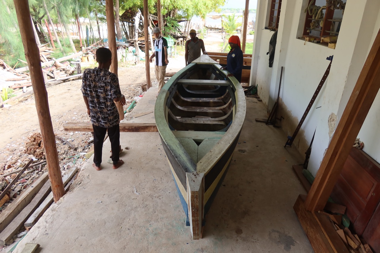

Step 1: First things first
First sit back and watch the full process so you can get an idea :)
Boatbuilding is a skill that needs a lot of practice and experience, but with this video and the following how-to steps, you might actually be able to build your own!
Let's see!

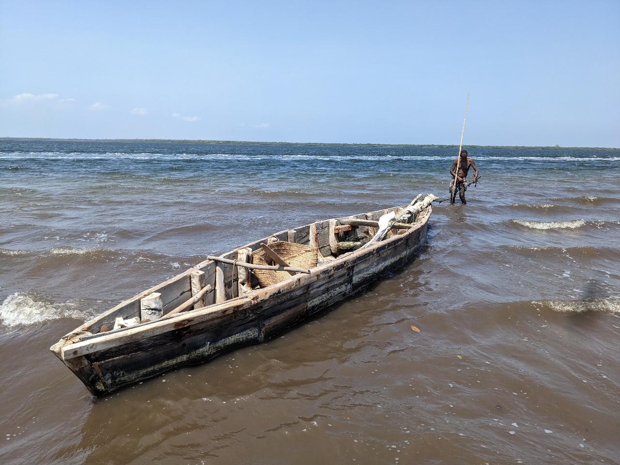

Step 2: Design Considerations
For this boat, we took an example and measurement of an existing traditional fishing canoe and made designs for moulds to fabricate the required parts.
Although we could design very differently (potentially more efficiently) with plastic, we decided to stick as much as possible to the original design, as this enables boatbuilders to use their traditional building approach and helps to teach and maintain their boatbuilding heritage.
For efficient use of materials, our moulds were designed with multi-use in mind (so the L-shape rib can be used as an L-shape bracket to reinforce different parts in a bigger dhow, or a “Muli” mould was long enough to serve for the canoe as well as the slightly bigger Taxi dhow). Note, that this also resulted in heavier parts than necessarily required.

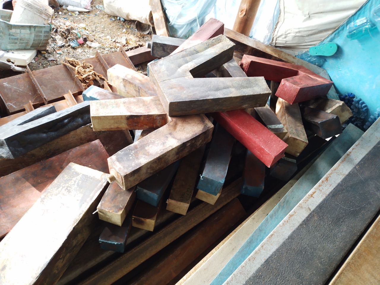

Time to prepare all your materials and tools for boat building. This is what you'll need:
Plastic material:
  • Custom parts for the L-ribs, V-rib and front/back "muli"
  • Lumber for the base, hull and interior (ideally min. 3m long) You don't have to choose exactly the same sizes - have a look what you have available that can be strong enough
Fixings: screws and bolts, corking cotton

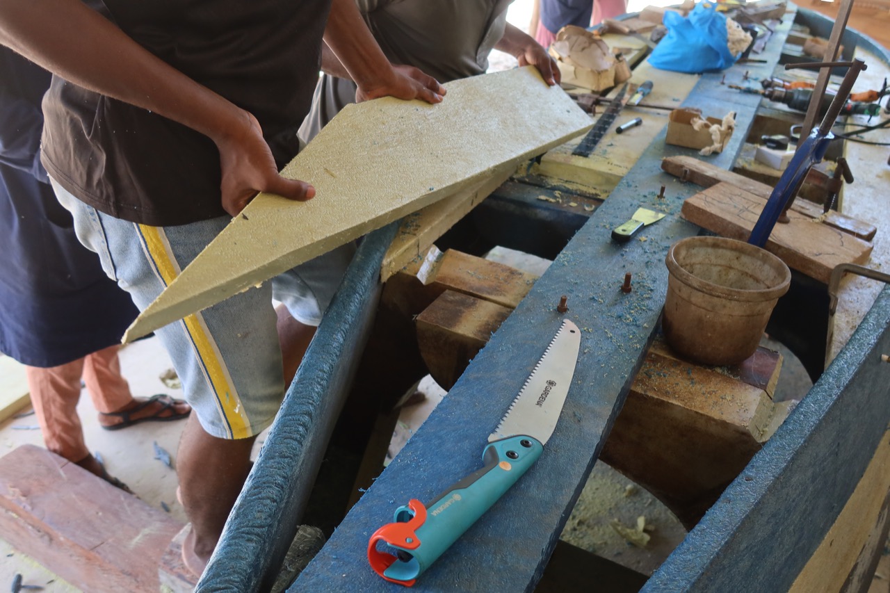

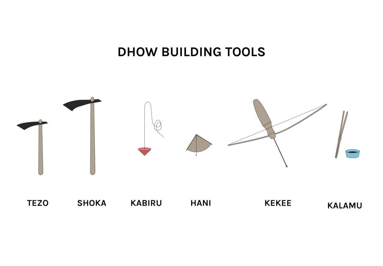

Tools:
  • standard working tools: saws, chisels, drill, screwdrivers, ruler, square
  • traditional dhow/boat making tools (see image)
  • heat gun (or welding gun) / melting machine

Note: Plastic planks can sometimes have a bend or twist. You can help bring them on one level by adding weight.

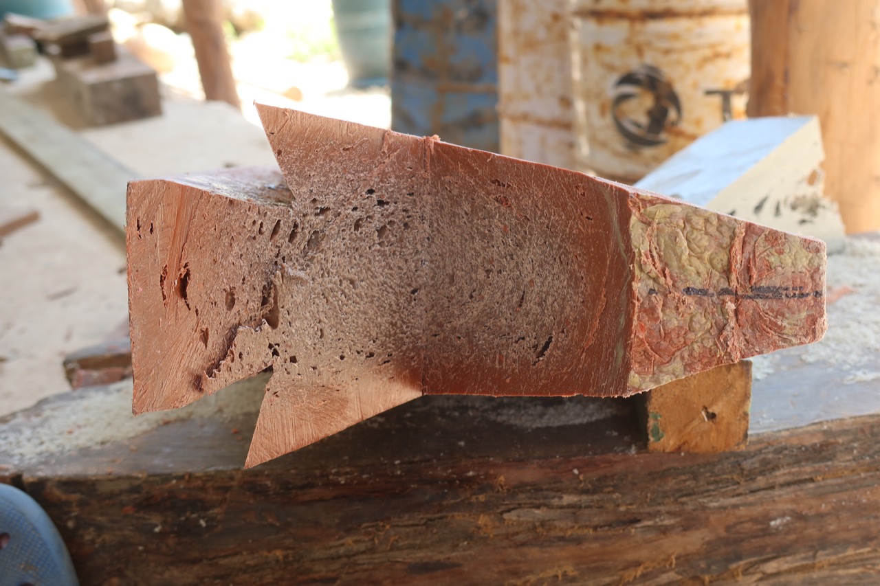

  • The V-shape beam sits on the Bitana. To join them, make a lap joint between Bitana and Farkumu.
  • Join them with a bolt through the keel

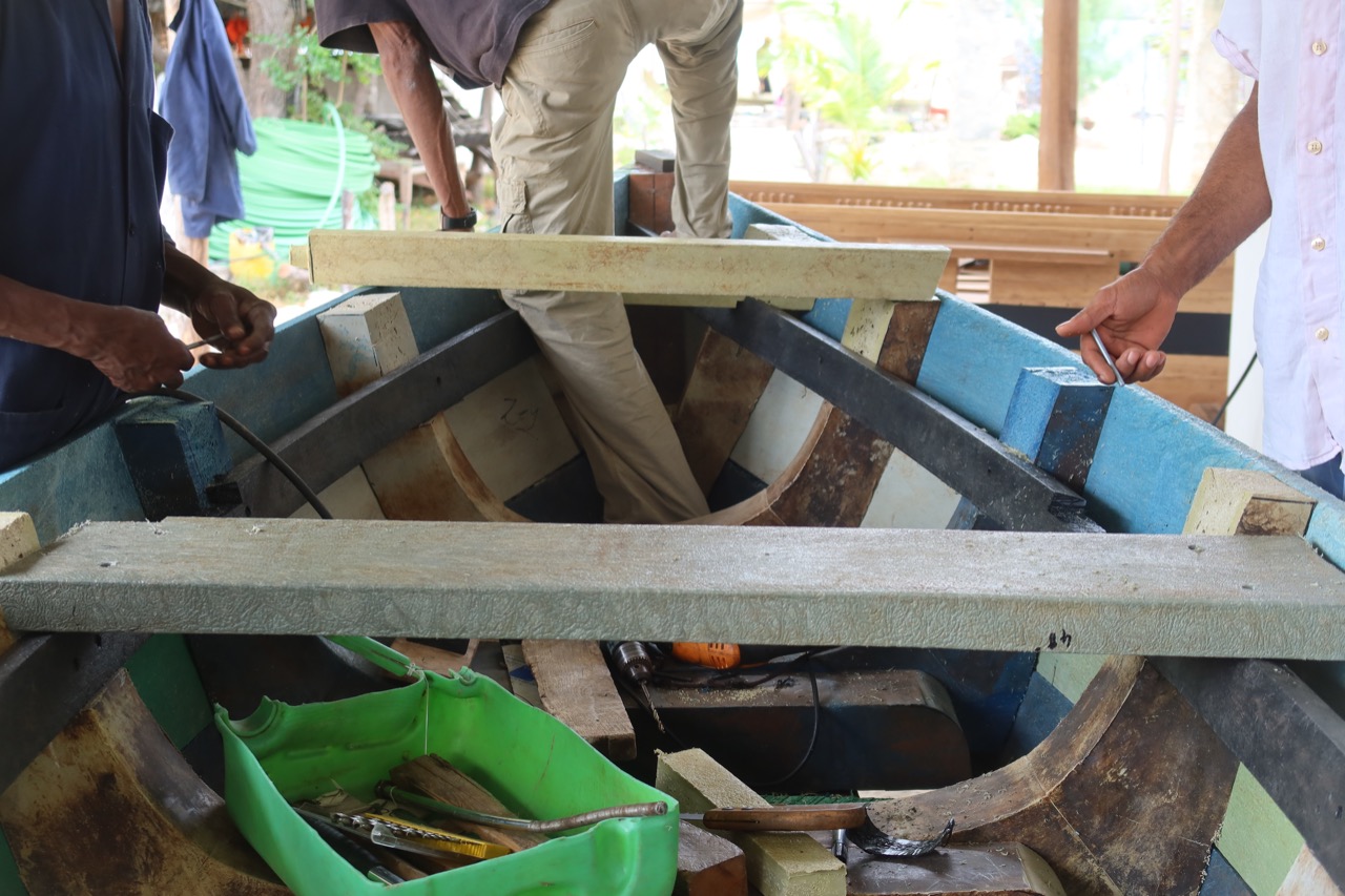

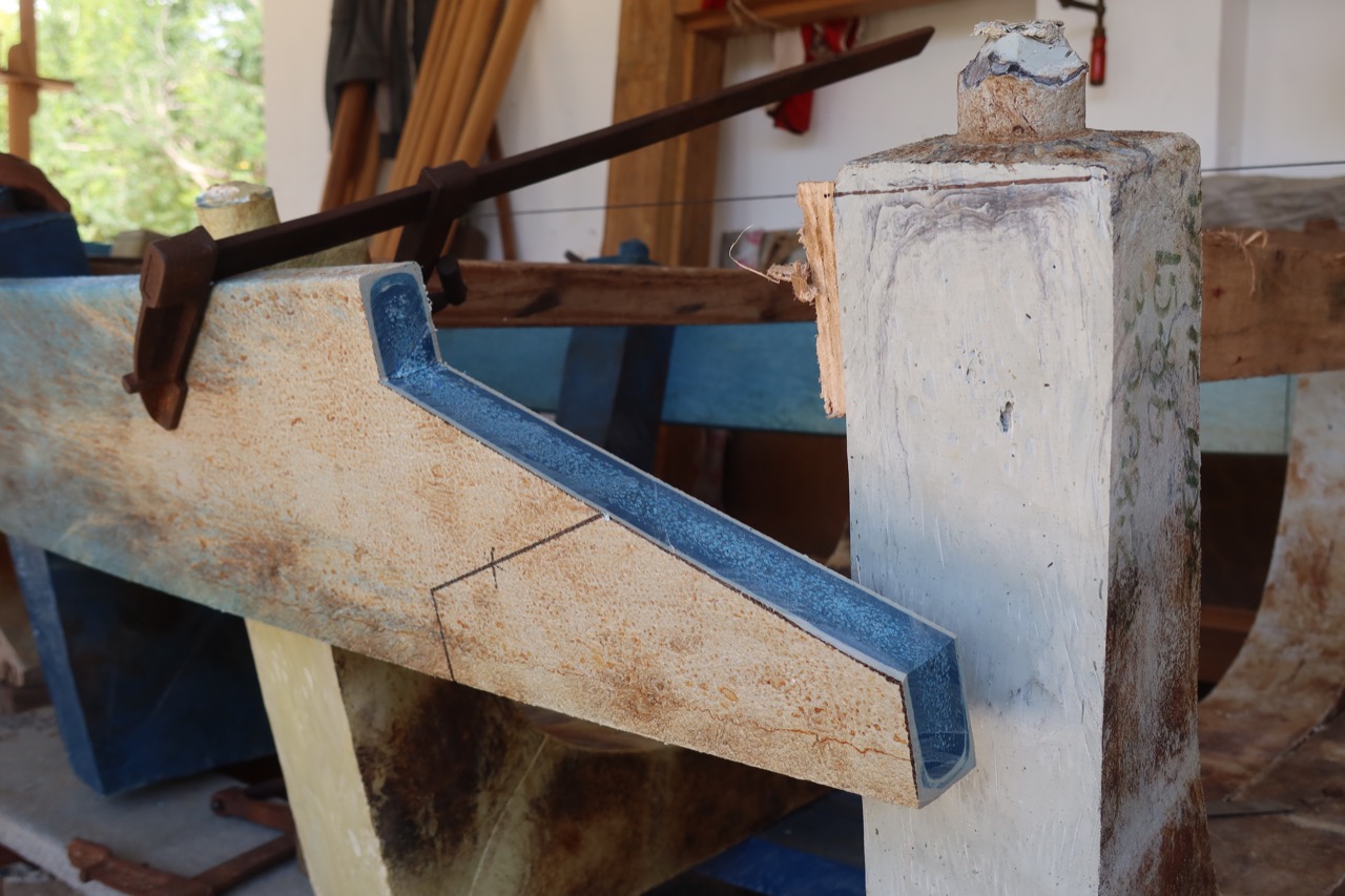

Step 12: Kinara (top hull)
THIS STEP TAKES A LOT OF TIME TO MAKE THE HULL FIT WELL.
Material: 9x1,5" x 10pcs
Start with Kinara (top plank)
  • mark and cut the bevel according to Muli
  • place plank in place and clamp it (we use our local technique "kisongo")
  • if necessary, adjust the ribs, so they are aligned nicely
  • fix in place with screws
  • take the second piece, repeat fitting and cut a Z-joint to join the pieces Do this on both sides, so the Kinara is all around the top.

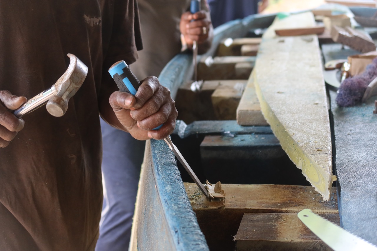

Step 13: Wajihi (rest of hull)
Materials: 9x1.5" planks (6pcs)
  • finish the other rows with the same process
  • in contrast to top plank (kinara), you can use a bevel joint between the planks instead of Z-joint -alternate the position of your joints as otherwise it creates a week point where all the joints are
MAKE SURE ALL PLANKS ARE FITTED TIGHTLY, SO THERE IS AS LITTLE GAP AS POSSIBLE. (you can use a saw in between to cut of uneven corners)

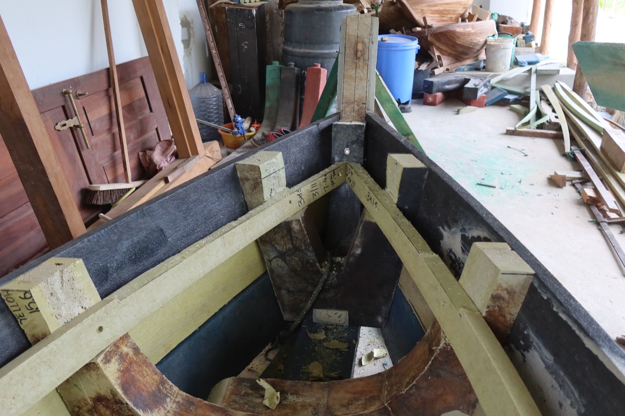

Step 14: Top locking
Next step is to lock everything well in place with side strips and crossing beams
Material:
  • Tampisi: 2x3" planks (4pcs)
  • Fundo la mongoti (crossing beam for the mast): 9x2"
  • Fundo la nyuma (back crossing beam): 9x1.5"
Process:
  • we cut a step into the ribs to make the tampisi and firari sit flush on the sides
  • place the tampisi onto the step and fix in place with screws
  • place a the "fundo la mongoti" on top of the tampisi at 1/3 of the keel from the front
  • place "fundo la nyuma" on top of the tampisi in the back (where desired)
  • make lap joints between Tampisi + Fundos and bolt them together

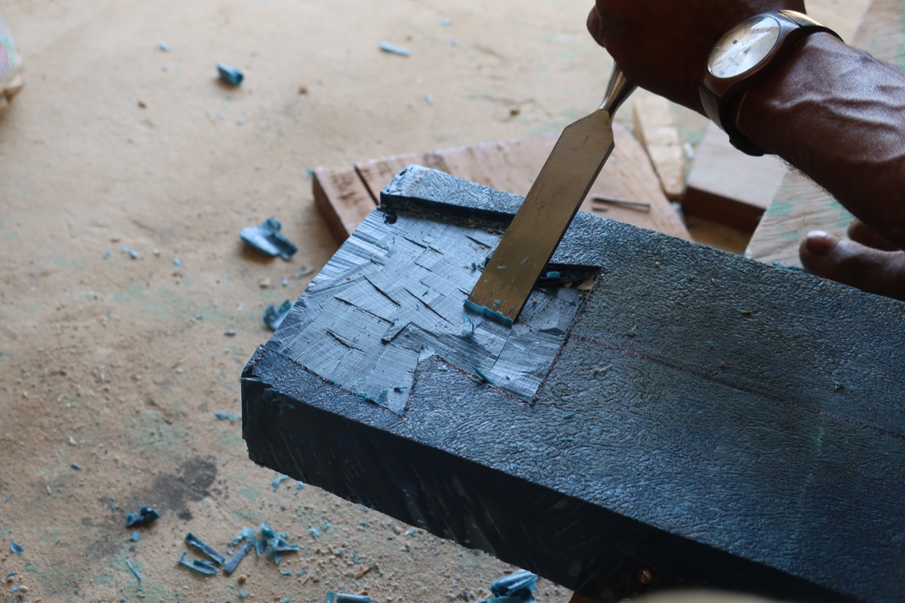

Step 18: Finishing & Sealing
Now last step remaining is to finish and seal the dhow, so no water can enter inside.
  • shave the excess corners of the planks to smoothen the surface of the hull
  • we used the traditional corking with cotton and hit it inbetween the gaps of the planks with the "chembeo"
  • to finalise, we topped up the kalafati with melted plastic with a heat gun to seal it completely (it's like plastic welding)
  • with the plastic welding we also sealed the screws and other gaps
NOTE: The plastic welding was done very low-tech and is to be tested! We hope to test a proper plastic welding tool soon for the sealing of the hull and will share the results :)
