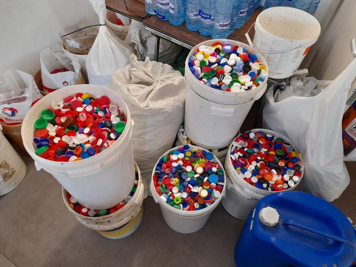

Step 3: Collect around 120 000 bottle caps
Collecting such a large quantity of caps can be a real challenge, so I'm going to tell you how I do it personally. I work with an association that collects the caps from schools, stores, public places, etc. before sorting them by color. I pay for this collection and sorting service, as it saves me dozens of hours of work!
Try to find such associations in your neighborhood! In our area, many collect bottle caps and sell them to recycling companies to finance humanitarian activities: dogs for the blind, wheelchairs for the disabled, etc...
For this project, we needed 240 kilos of bottle caps.

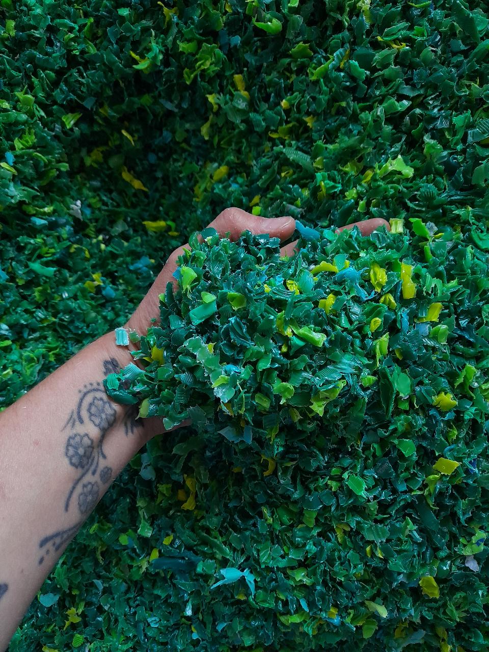

SHREDDING
I use a V4 pro shredder to shred the caps 4 times, until I get the right size of shred for my needs.

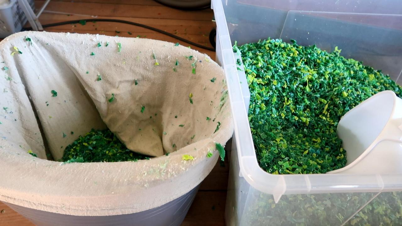

WASHING (and DRYING)
I find that washing is more effective when done after grinding, rather than before. So I put my shredded plastic in heavy-duty cotton canvas bags, which I seal carefully with reusable zip-ties. I then wash them in domestic washing machines, with a filtration and water recovery system. Filtration prevents the loss of microplastics into the environment, while water recovery enables the washing machines to operate in a closed cycle, reusing the same water many times over, for a multitude of washes, before being renewed.
I then dry the bags of shredded material in tumble dryers (powered by solar panels) to obtain perfectly dry, moisture-free shredded material.

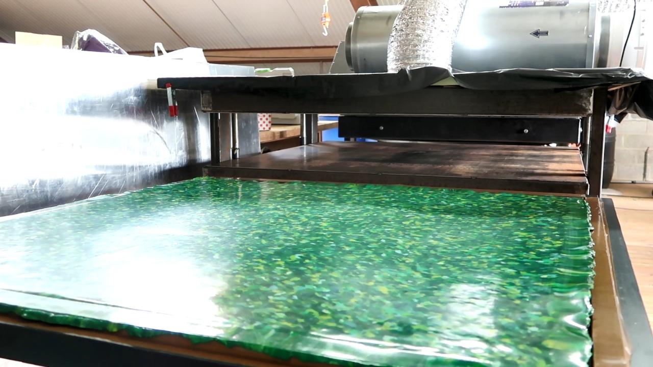

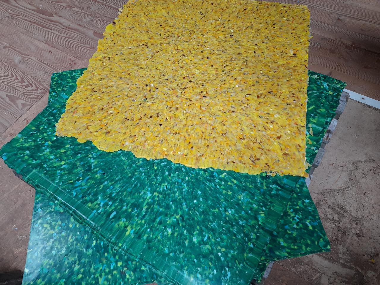

Step 5: Create your sheets using the sheetpress

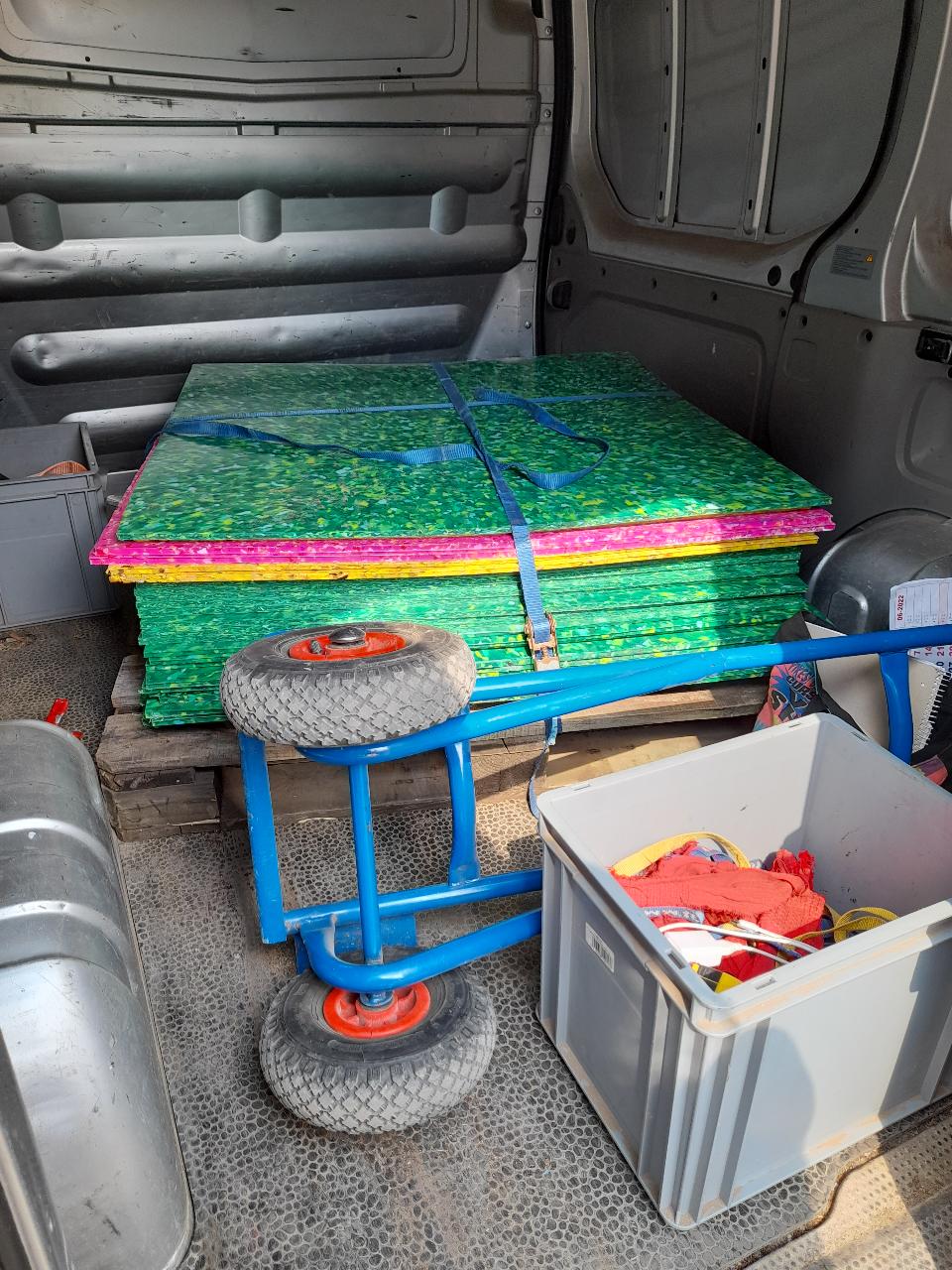

Using the method explained in a previous "How-To" ( ), you should be able to make between 6 and 8 sheets per day.
For this project, we needed 24 panels, including 4 yellow ones for the nesting box.
So you could be finished after 3-4 intense days, good job!
(Don't mind the pink ones, they were for another project in our daughter's room!)

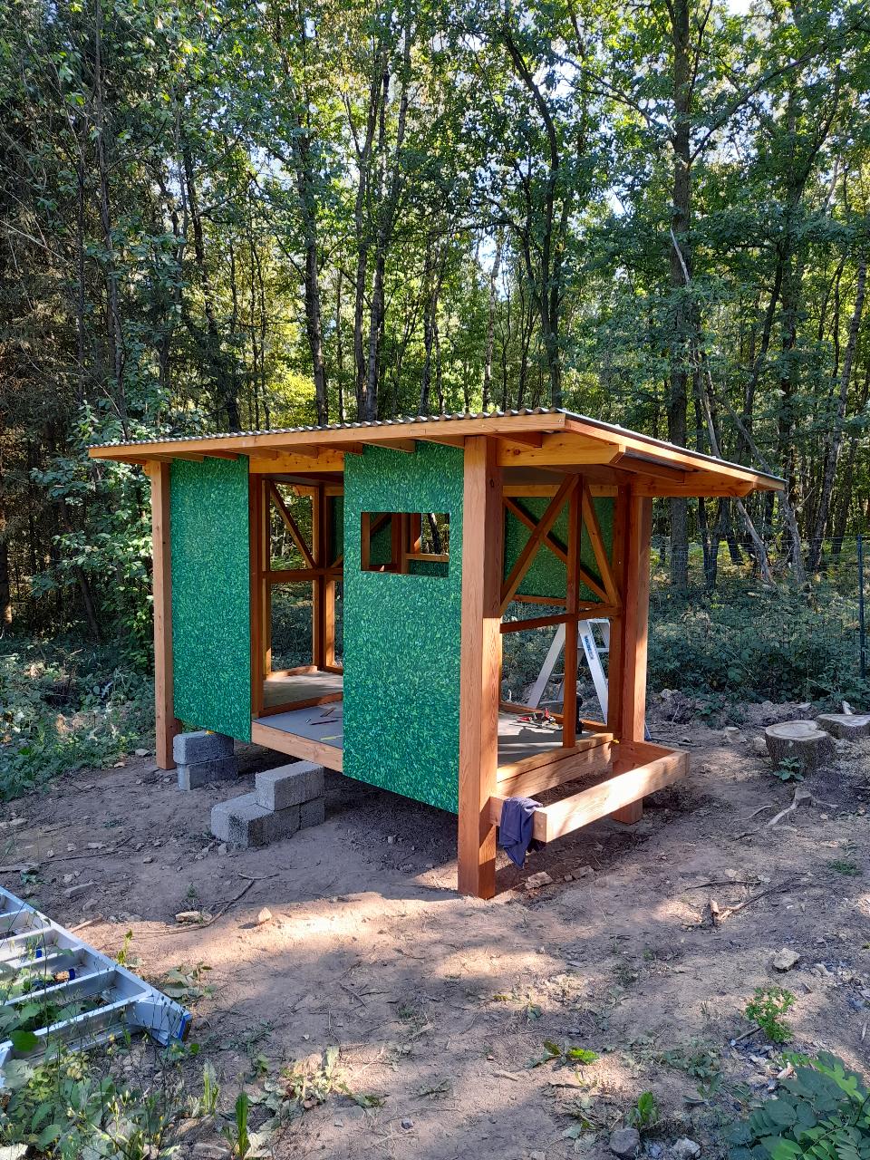

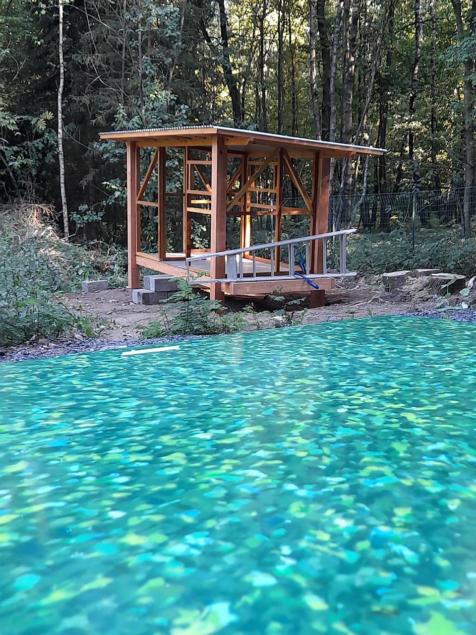

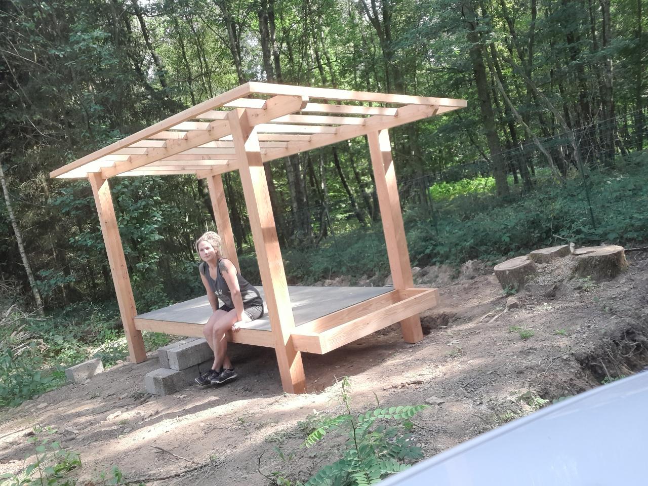

Step 6: Build the wooden structure and the roof
Build the wooden structure following the plans provided in this “How-To”.
Of course, you will have to adapt to your own location and your available materials.
In our case, we had Trespa panels in stock (from my partner's ordering error for a previous professional project) so we used them for the floor and ceiling. If you don't want to buy Trespa panels, you can adapt the structure and also use recycled plastic panels instead.
The roof of the henhouse was insulated and then covered with corrugated iron sheets.
As you will see in the plans, we wanted to provide a small storage space next to the chickens' living room in order to be able to store equipment there. It is accessed from the outside and not the inside of the henhouse.

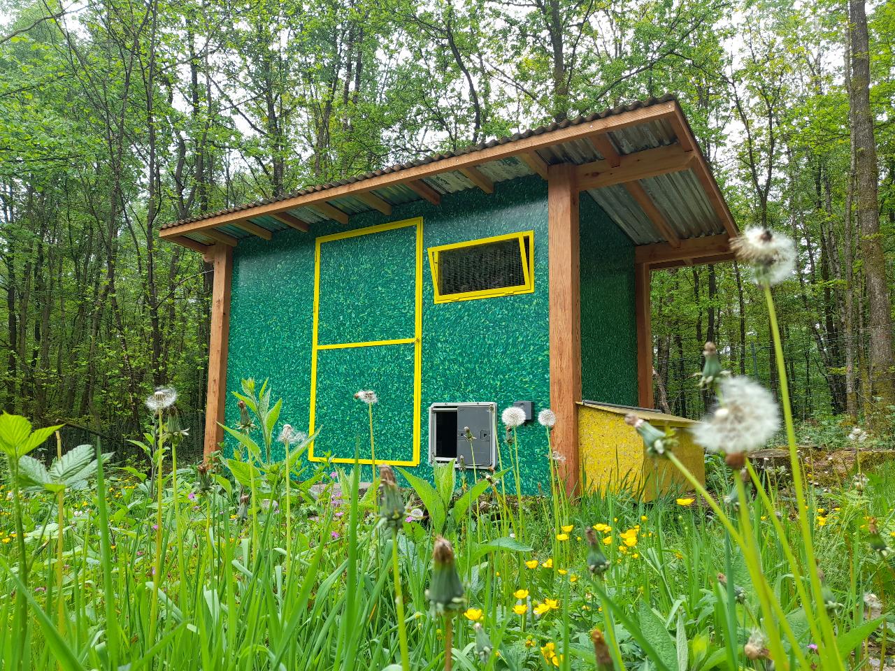

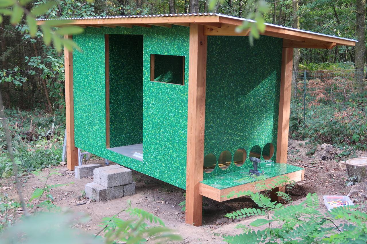

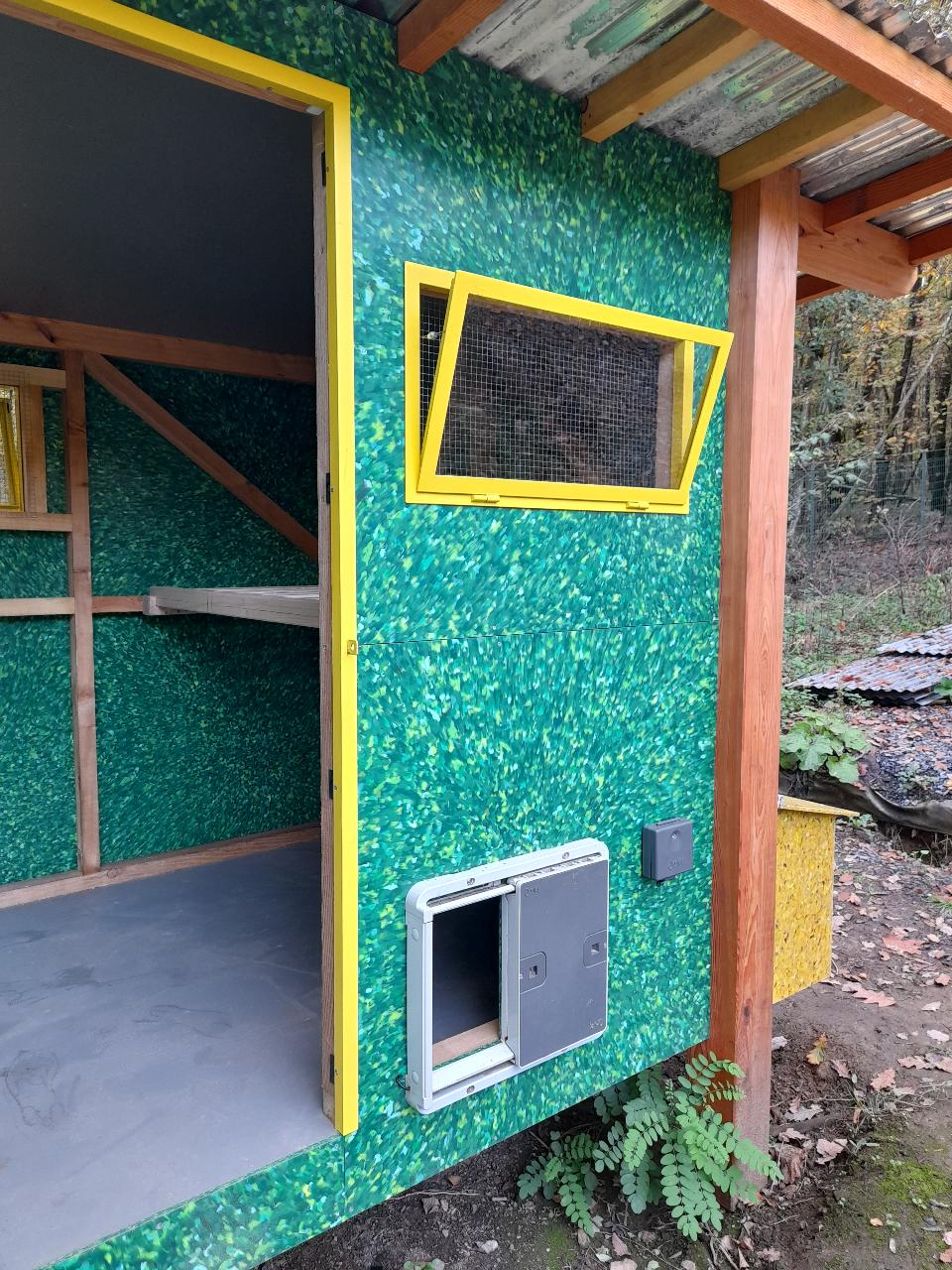

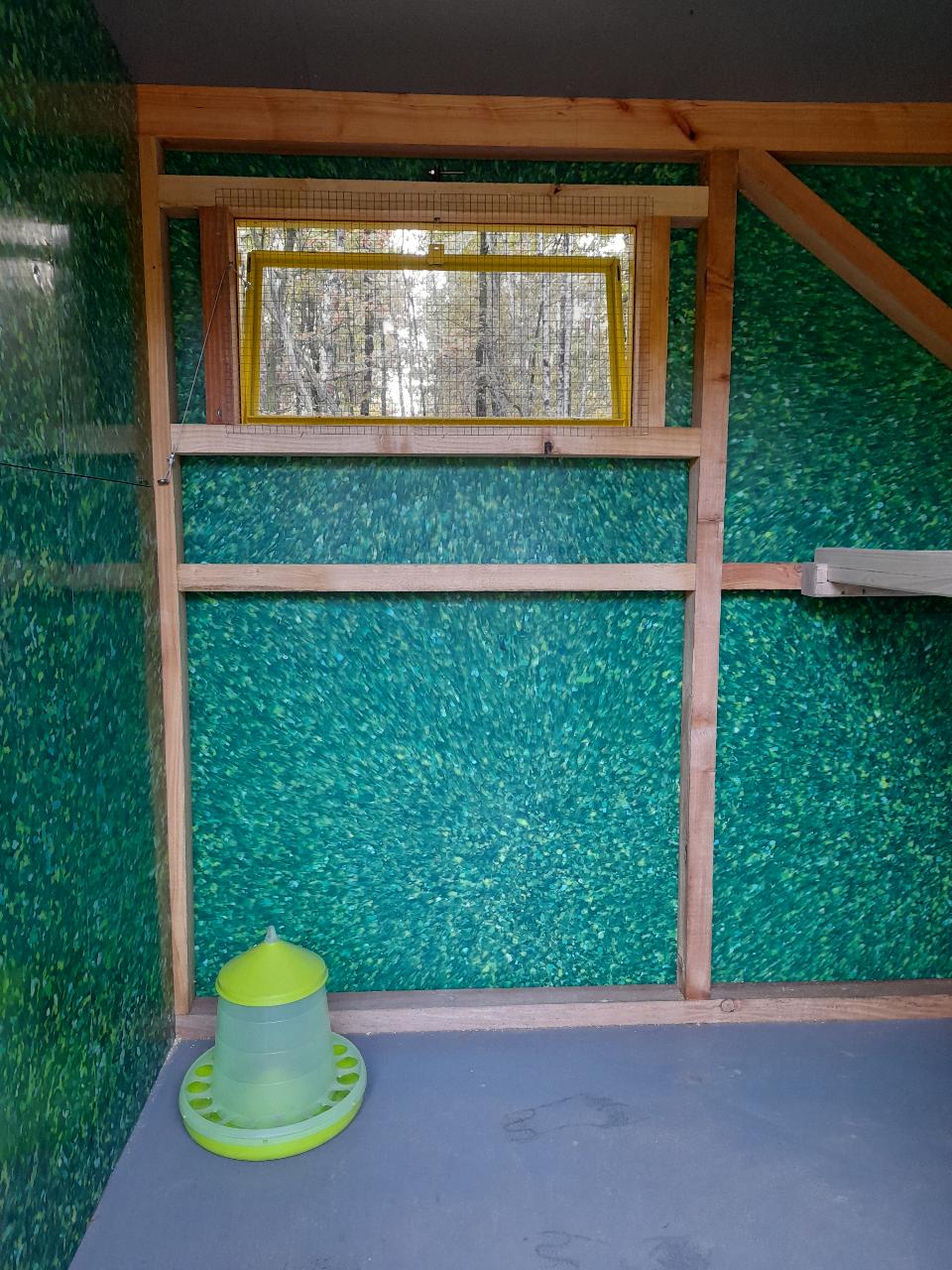

Step 7: Cut and add your recycled plastic sheets
It's time to dress the interior and exterior walls of your chicken coop!
Be very careful when cutting your panels, do it in a place that allows you to collect/vacuum up all the plastic dust created by the cuts, so that this plastic does not end up in the environment. To attach the panels, you will need to pre-drill (recover any plastic waste that falls!) before screwing to the wooden structure.
Step 8: Allow space between your panels !
We made the "mistake" of not providing space between the panels, which does not allow them to expand properly when it is very hot, and some panels can end up a little bulging.
To avoid this, it can be good to allow 0.5cm-1cm of space between the panels.
Depending on the season in which you build your henhouse, and the temperature differences that you may have in your country (between summer and winter), you could notice big changes in the expansion of your panels, this is normal, but you must anticipate them during construction!

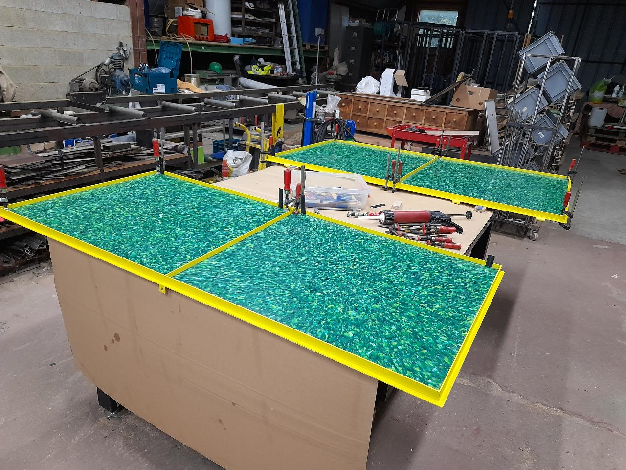

Step 9: Create your doors and windows
Our doors and windows have a steel structure, which has been painted (with the family!). We first used putty to glue the panels to the steel structure, but it didn't work well. We therefore opted for a mechanical solution.
Personally, we decided to add a metal mesh to the windows to prevent the intrusion of martens or rats.

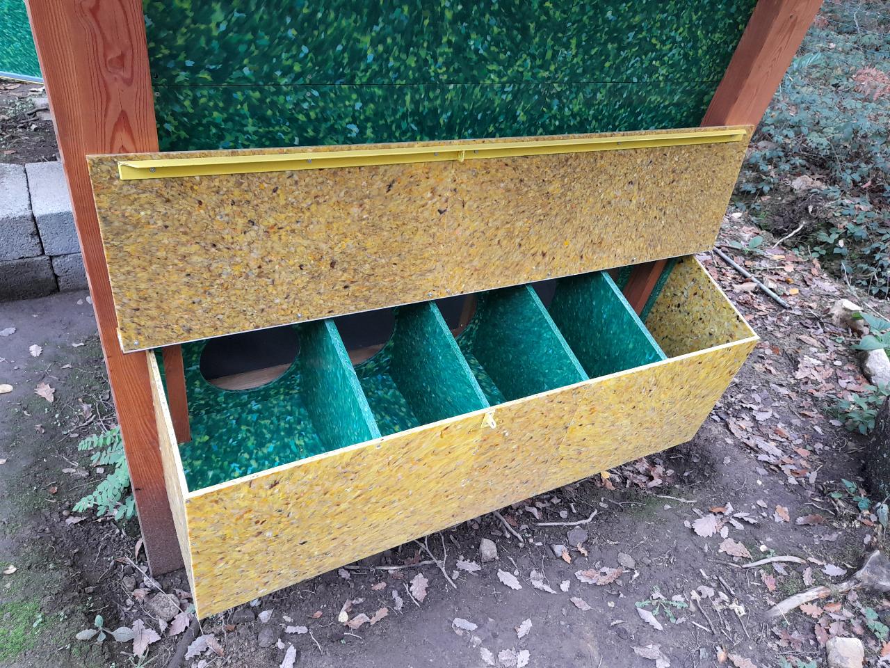

Step 10: Now, the nests !
Then build your nests, always using the plans and adapting them to your needs. Be creative and don't be afraid to go for a different color!
Step 11: Add the last elements
If this is not yet done, add the interior perch, the automatic door for the chickens (we chose an Omlet brand door, which we bought second-hand). Again, adapt to what you find or already have!
