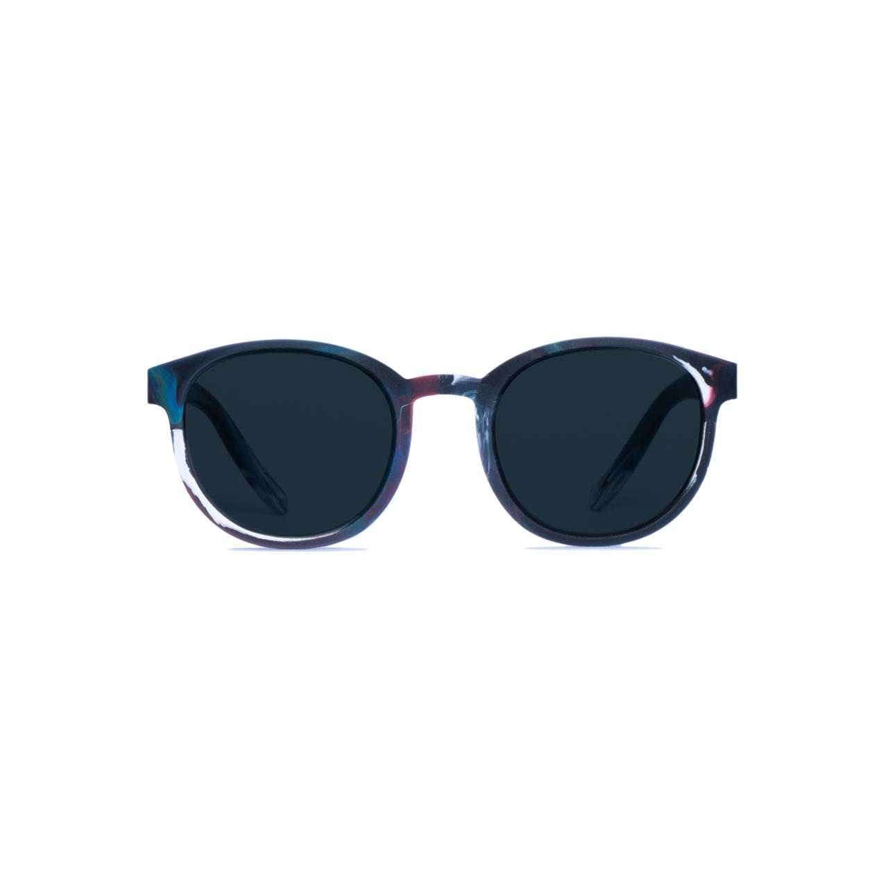

Design moulds for sunglasses At Esfèrica weve been working to understand how to uphold the value of waste plastics for the past 5 years. Today, our project FOS Barcelona offers eyewear made with local waste and moulds for others to fabricate them in their area, in an effort to enhance distributed design.

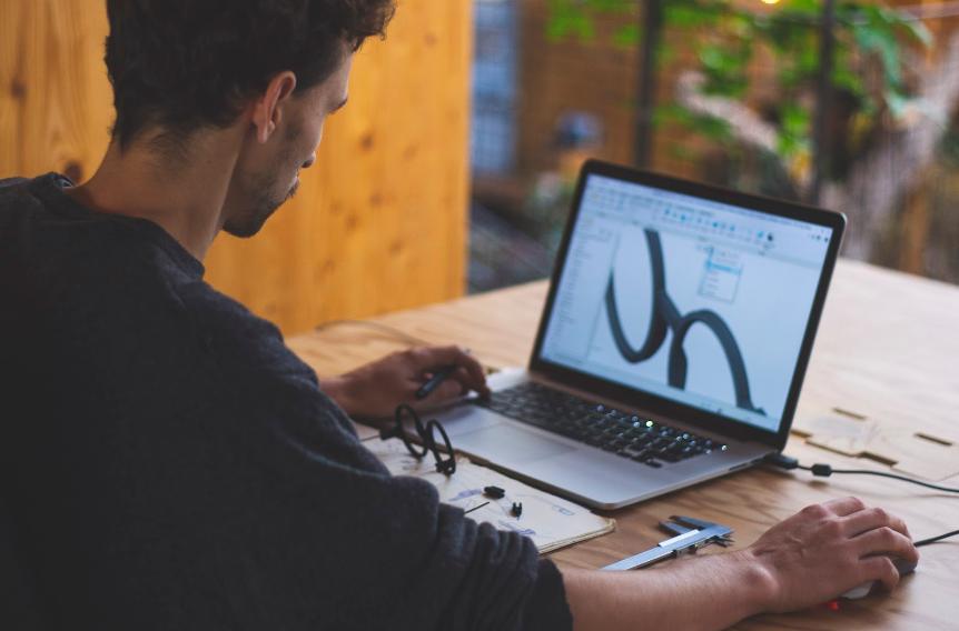

  2. A computer and some experience working with CAD software.

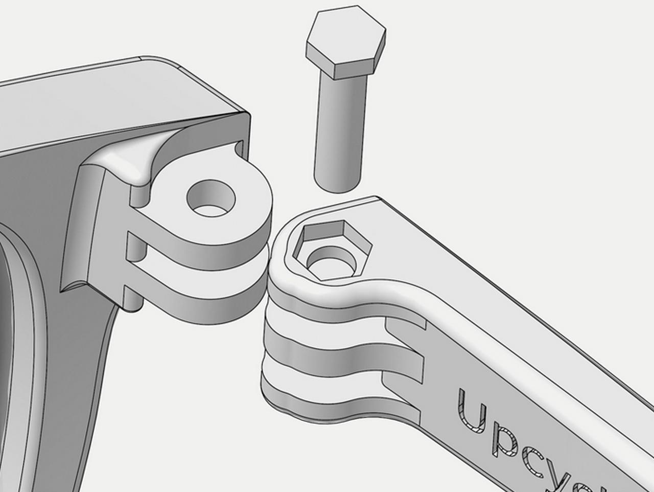

Step 3: Sunglasses model - Hinges

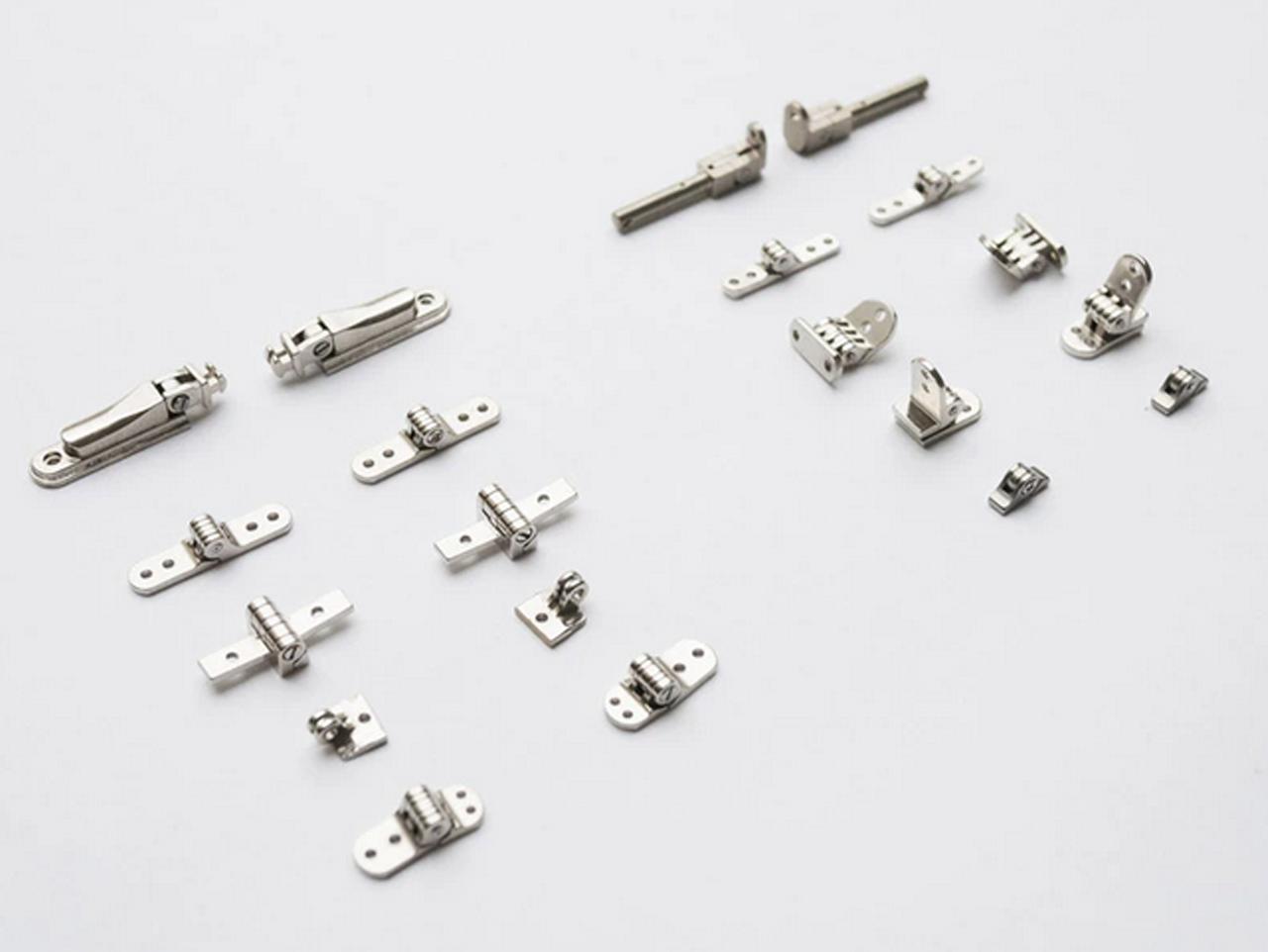

Metal hinges: There are several metal hinges options in the market, being the most common riveted - fixed with rivets -, in mould - placed in the mould before every injection -, screwed in - inserted after the injection and fixed using screws -, and fused - inserted after injection using heat -. Of all of them, the easiest to detach from the product once its lifespan is over, is the screw-in models and that is the reason we choose to use this one.
Plastic hinges: See next step
Step 4: Sunglasses model - Hinges
Plastic hinges: Made in the mould. This is the most sustainable choice. No materials mixtures and durability that might go beyond eyewear with metal hinges, if designed properly. The downside is the quality perception, a key point when developing products that need to sell, and a parameter that many times has no connection to actual quality, but rather with the different perceptions around materials and products present in each corner of the world.

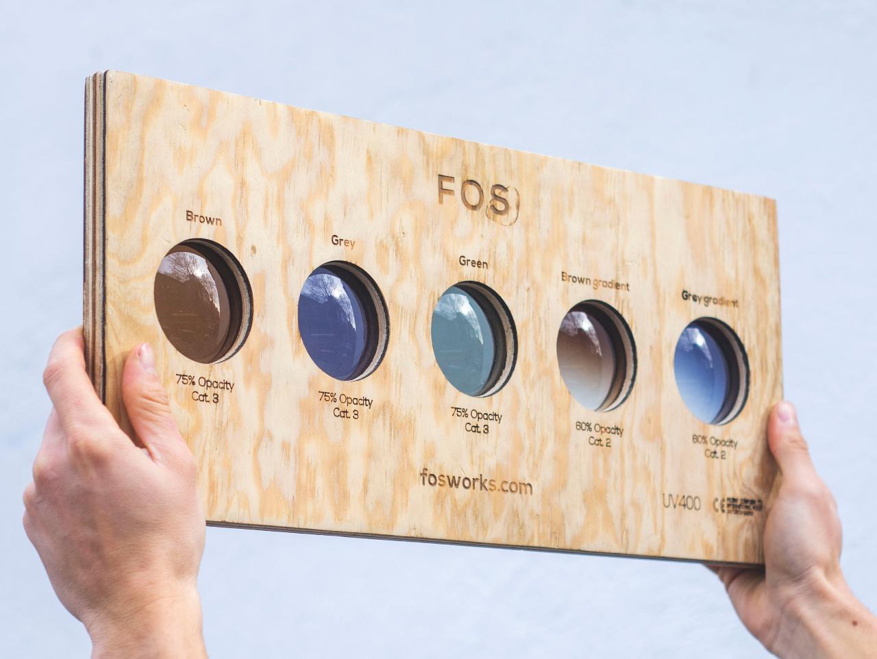

There is a wide variety of lenses in the market. Again, depending on your target and the type of eyewear you want to make you will choose one type or another. The main ones are the following, although there are many others for specific applications:
Polycarbonate: Lenses for sports and action eyewear due to its resistance. CR-39 (polymer): The most used type of lenses. Mineral lenses: The glass lenses that are used less and less due to their weight and the fact that they break when falling. The main advantage is its scratch resistance.

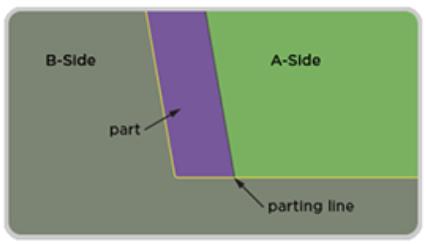

If you go for a cheaper mould, then go for parting lines in the edge of the parts, making it easy to post process and to achieve good final results.
If you go for a good mould, place them either way, since they will be good enough for you not to post process them or simply polish them slightly. In this case, design choices might be the parameters that will help you decide. The images you see show how to slightly hide the parting line by adding a round up, which will make the mould slightly more expensive (especially if you do this on small features that could want a few tool changes and a lot more time) or how to keep it simple.

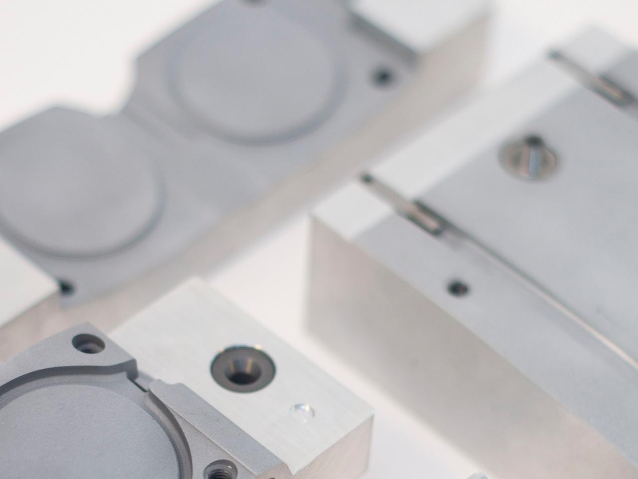

Closing system: How complex? A closing system that allows for faster productions can be very costly. The clamping pressure in an injection mould is vital for good results and mould life. It is, however, not easy to find a system that allows for constant mould change and high enough pressures, evenly distributed, at a low price. Using simple screws is a good solution for a smaller budget: Its cheap and offers a perfect clamping pressure if they are placed right. However, it will be slower to open and close the mould. Our recommendation is to start with screws, understand your real needs, and work from there.
