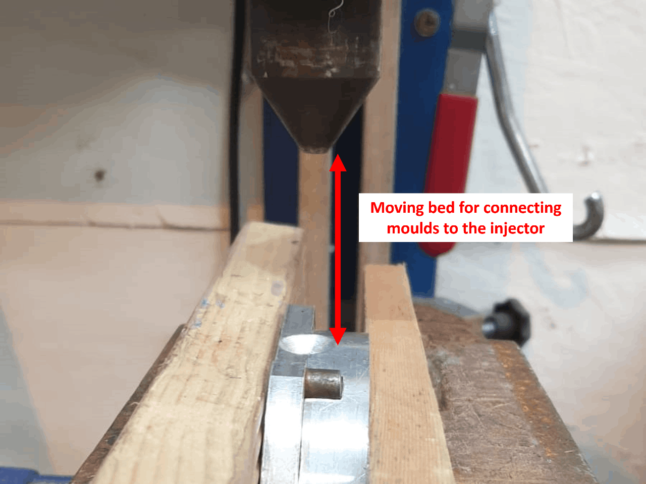

Step 3: (if wall-mounted) Make it taller
We used 4 pieces of 3x2 in each corner of the flat plate of the stand finished with a flat piece of wood on top to create a higher bed for the moulds to sit on. This could easily be made of metal and be differently shaped if required. We find the gap in the middle of the pillars is useful for storing the 'height-raising blocks'.
You might find you have enough height already or you can add wooden blocks to raise it up if required when using a floor-based injection moulder.
One modification to this design would be to make the pillars shorter and then add a tufftuff jack on top. This alleviates the need to use different thickness wooden blocks depending on what mould you are using as you could use the tufftuff jack (with a plate on top) to change the general height you want to work out, then use the bike stand to get the extra travel you need to interface with the nozzle.
