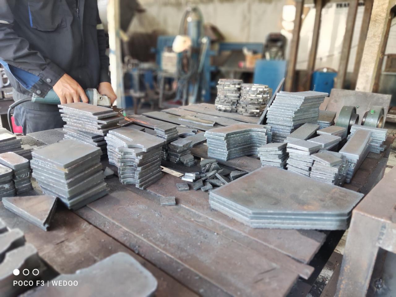

Download the plasma cutter files and follow the instructions and cut your machine parts according to the thickness of the metal plate . You can also bring these sets of files to a local machine builder to get it cut there.

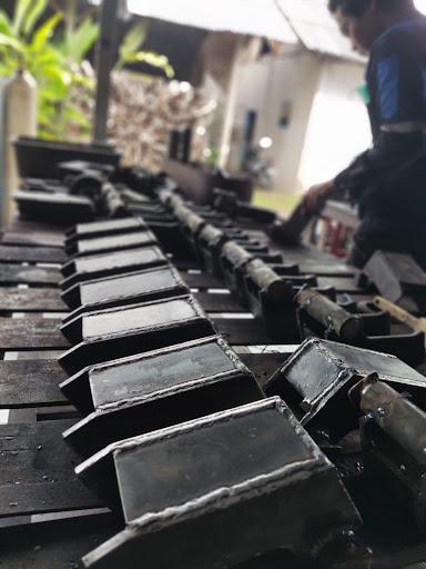

Hinge are consisted of two parts, the one that are fixed to the door and the one that are fixed to the frame. you can cut all the parts with the plasma cutter and weld the assembly together.
once hinges and locks are made, we recommend to attach the hinges on the main frame first (check step 7)

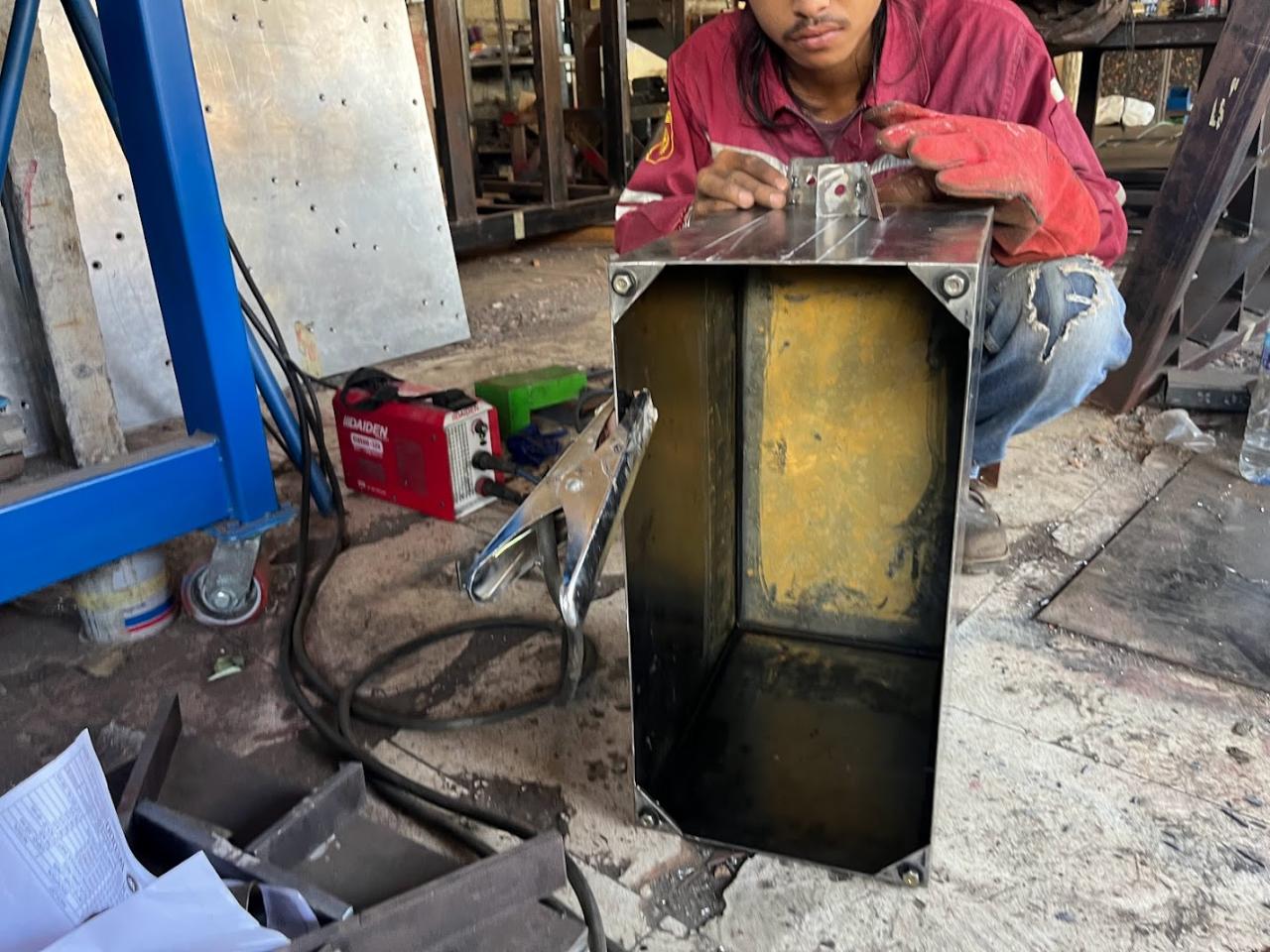

Step 8: Build oil tank and case for the motor
Make sure there are no leaks in the seams
attach it to the top part of the baler according to the 3D drawing.

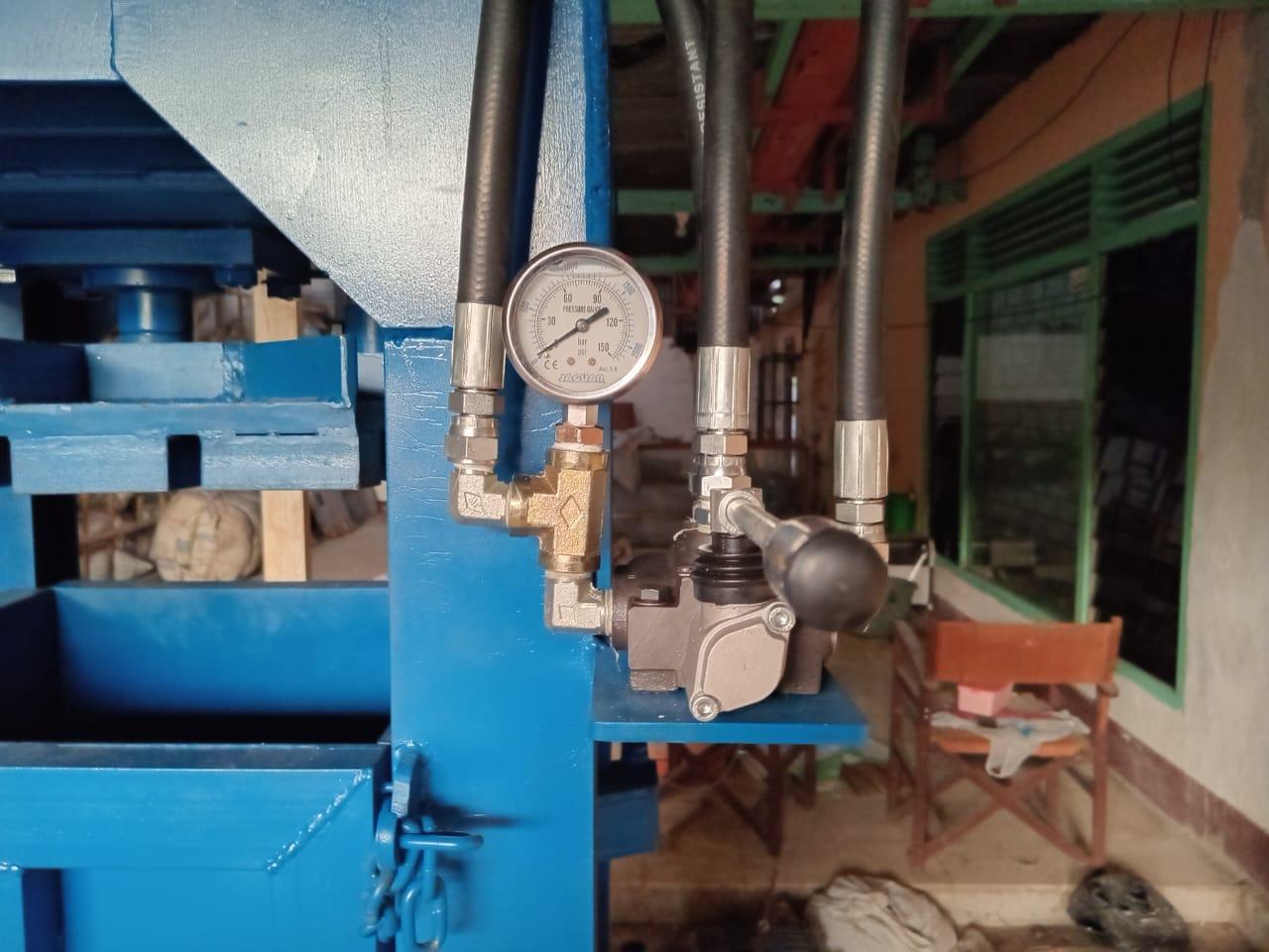

  5. Lower Handle valve until pressure gauge gets to 100 bar (max hydraulic capacity
  6. Release 7.Add more plastic until you achieve your desired dimension and repeat the process
  7. Open the door 9.Tie the baled material
